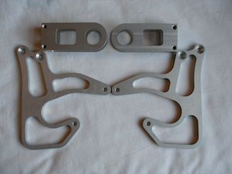

Small things make the biggest difference... for those that have been following this blog may remember that that I strongly believe that chrome has no place on a sports bike and that has been a driving force on getting bits changed/remade/repainted etc along the way.
Well the rear chain adjusters have been a constant niggle, there is nothing on the planet that I could find that allowed me to change these things, I didn't want to paint them...
so what was the outcome? being knee deep in work I took the lazy option and chucked the original adjusters at Pete at Ti64 with the instruction of make from 7075 aluminium and give them the best corrosion protection possible and oh, please make them look awesome...
then fast forward a day and a brain wave emerged that now was a good time to add some detail to the adjuster that would enable me to better lift the bike with my paddock stand so I hunted and liked the look of the MotoGP hooks, so I threw an image Pete's way and said make it so...
He came back and said he had a CNC guy he uses but expect a wait... so I waited...
and waited....
and waited some more!!!!
and eventually I offered some money and waited...
and then a parcel arrived...
with these inside
Tomorrow (Saturday) is fitting day, could say I am happy that they are exactly as I wanted and the look I am after, and thank fully no chrome...
and waited....
with these inside

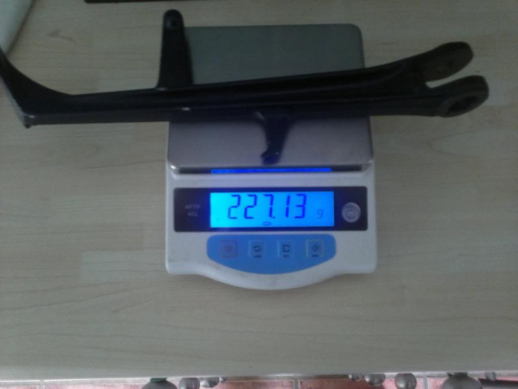

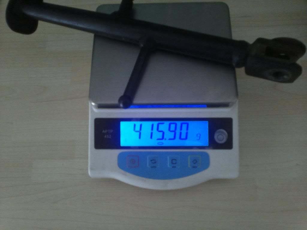

So with the idea that the newer CBR1000RR has a lighter sideside 1 was duly purchased and it's weight was checked against the old item
old
new
so, just under half the weight

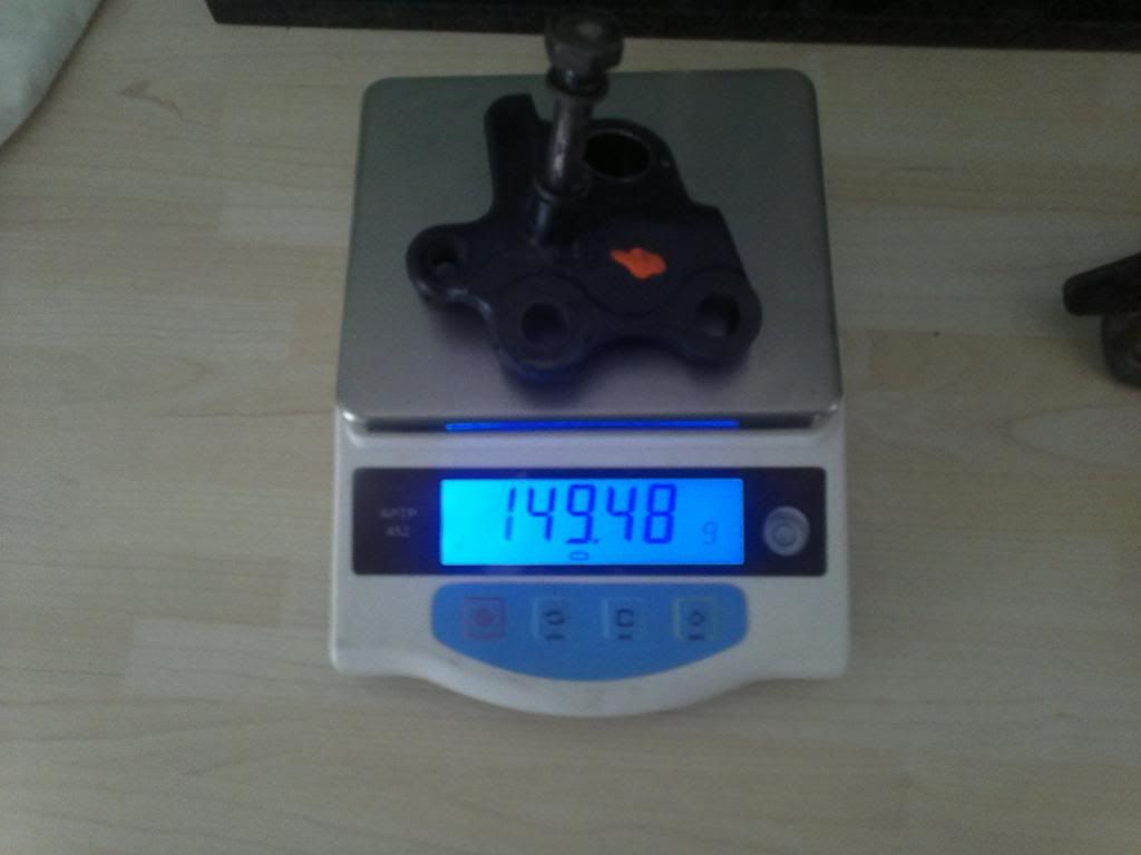

and then then mounting bracket
old
new
so again a small saving which will actually get lighter in a moment lol...

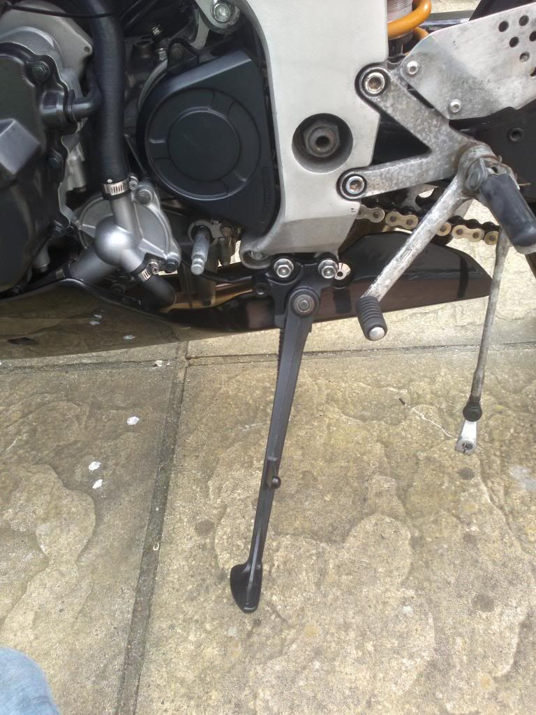

so on fitting to the bike, it all bolted up, the stand itself is slightly longer than the RRW item but it works perfectly, the bike is held more upright (no idea if this will cause a problem, time will tell lol) but it is still lent over sufficiently...
On the CBR1000RR mounting bracket there is a small threaded boss which is not needed on the RRW, this needs to be ground off as it prevents the gear linkage from fitting, sadly I am at home and all my tools are at work so no grinding until Monday, the neighbours will be pleased!!!
fitted
and clearance issue with the boss
So with the old one put back on for now it was time to address the rear chain adjusters.
I think with all the weight removed I am allowed to add a little bit of weight, comparing the old adjuster to the new ones with the paddock stand hooks, the new ones are about 30 grams each heavier so I think I can live with that lol...
Now I just need to modify my paddock stand to have bobbin pins on the ends and they will work a treat. I realise I won't be able to remove the wheel with the new hooks but I have other plans for that aspect of maintenance.
old
new
old
new
fitted
