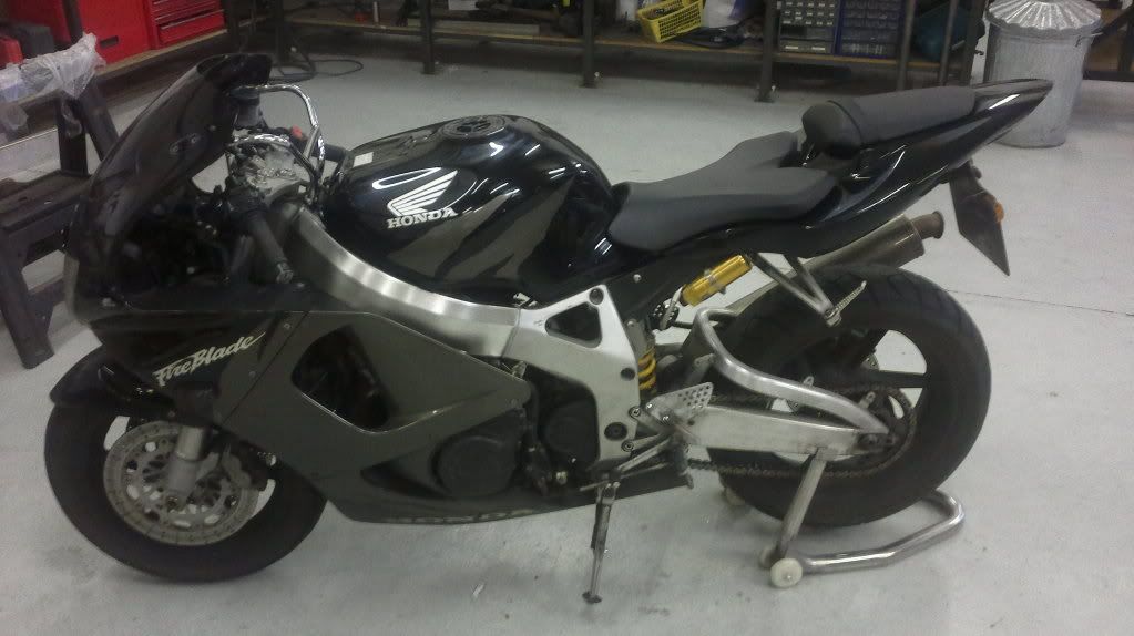

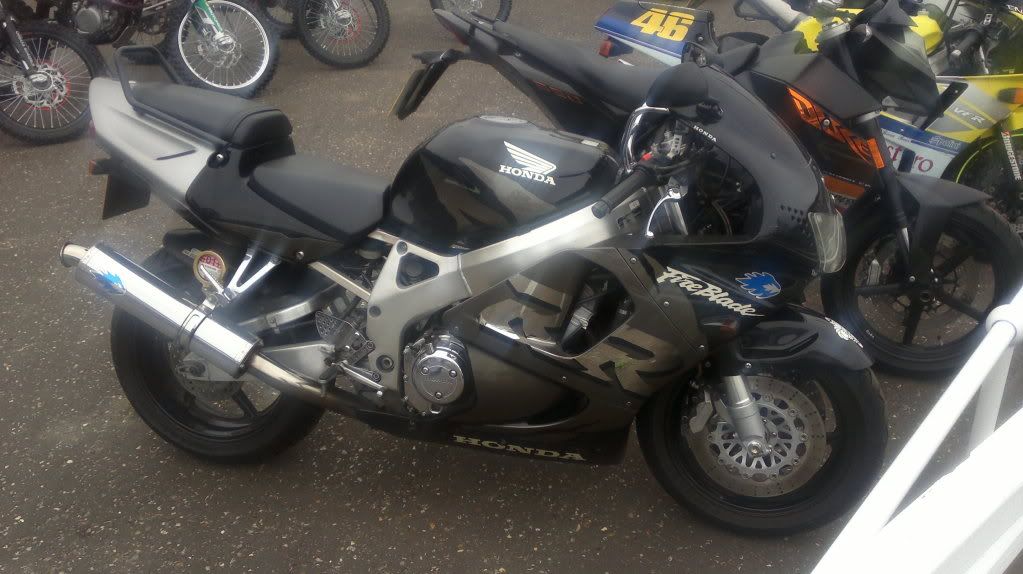

how I first saw it at the bike shop I bought her (rescue???) from
One largley standard 1998 RRW, in black...
She was in ok condition... bought her with the intention that she was going to get tweaked in the rear as the main thing.
My main criteria was that she had to remain useable as I ride to work everyday, which does create the odd issue as projects have to be planned with as minimum downtime...
but the main thing that I hated was there was loads of parts that had awful flaky chrome, (disclaimer alert), now it must be said I am not a fan of chrome, so to all those that love chrome look away now...

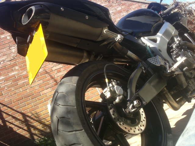

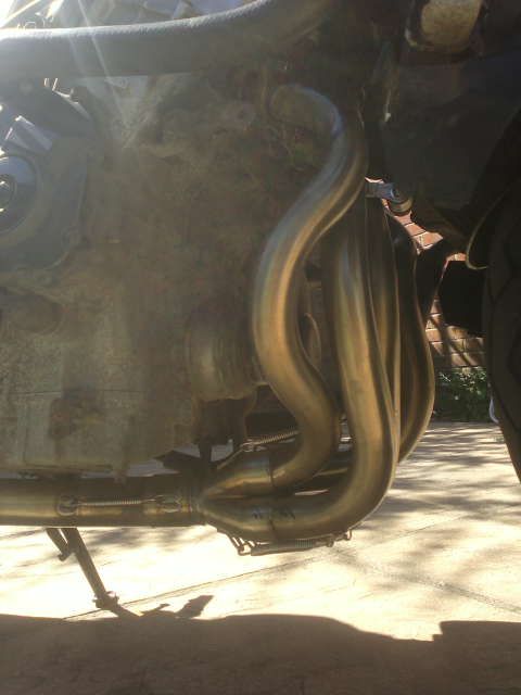

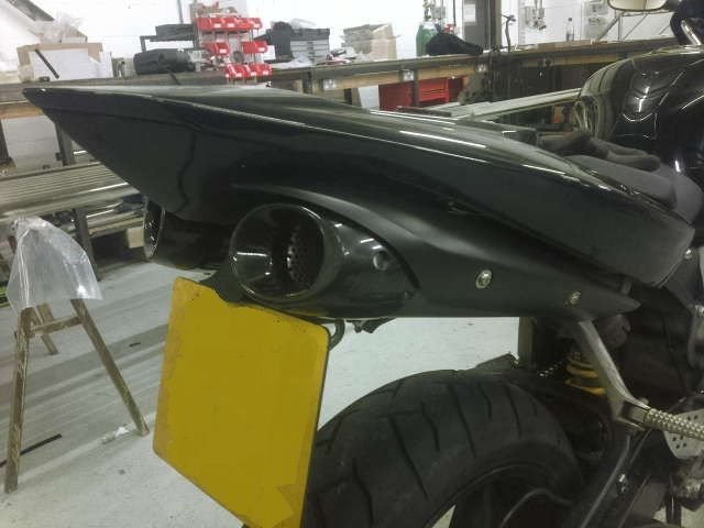

and then I mocked the cans up to start modifying the mid pipe
These are standard R1 cans which I have debaffled and then had made custom carbon tips to replace the standard ones (reason being that I bought a set of cans with a dented tip
I have made new headers to go on as well...

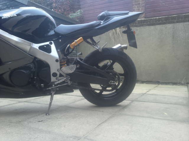

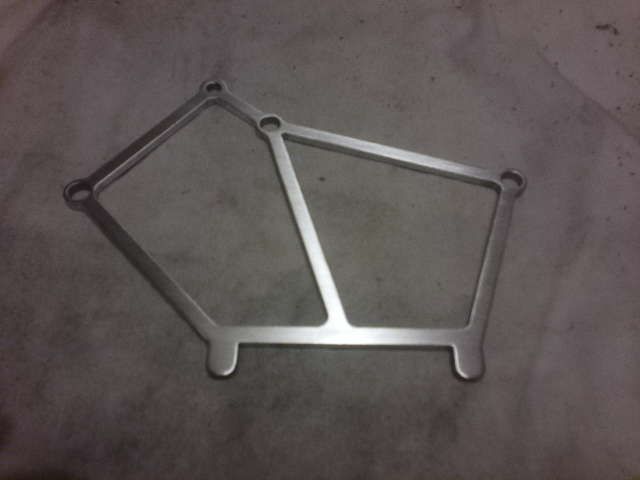

I have an unhealthy obsession with Titanium fixings and replace them at every opportunity when I rebuild or replace something.
My current project is I am designing and making my own rear sets as I haven't found anything that i truly like out there, they all seem a compromised design... and yes all fixings are Titanium (i did tell you lol)

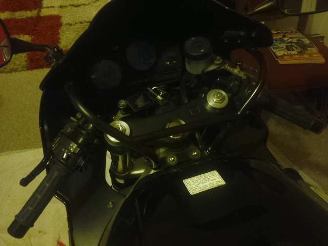

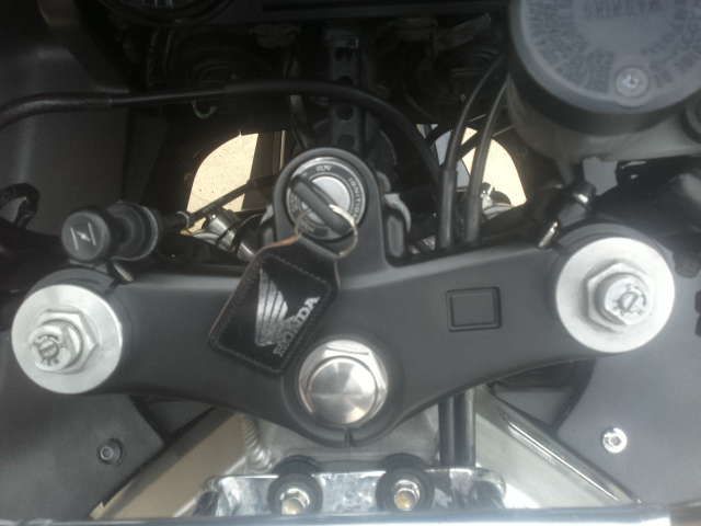

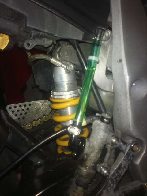

Swingarm is already black as is th top yoke, i'll add a pic to show.
since this pic was taken i have since replaced the chain, rear sprocket and front sprocket
Frame, no, this will stay as anodised from the factory as i like the contrast and makes it all more monochrome.
Rearsets (foot rest hangers), i actually have parts in the machine shop making my own design as I could find anything i truly liked, everything all looked a compromise. So started from scratch and have design what suits me with no budget constrains or marketing men interfering with the design, bearings, rose joints and Titanium fasteners have all been ordered and starting to arrive
I have the parts to do the F4i dash conversion, just need to measure the bloody bracket, but in the mean time i change the clock faces on the standard dash to blue

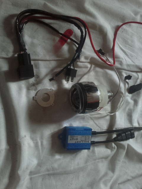

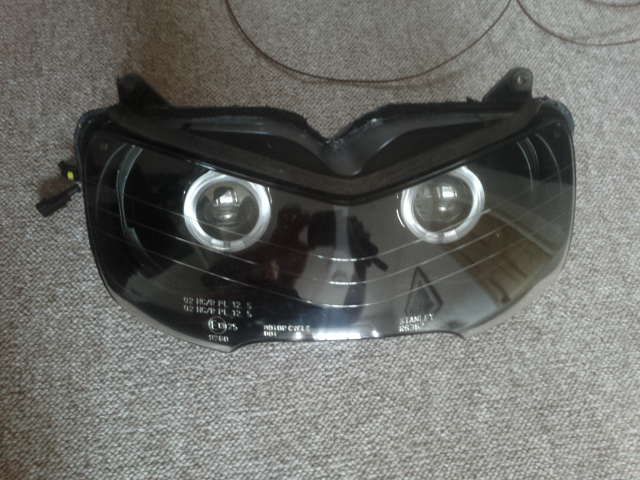

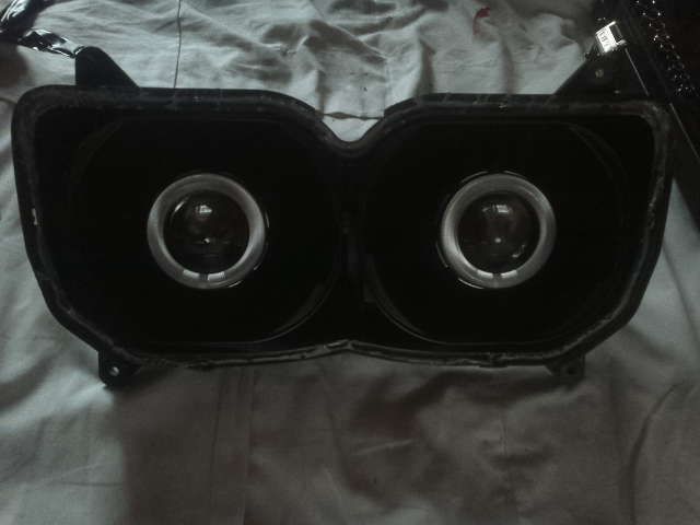

and I finally got round to actually doing my Bi xenon projector conversion. Both sides, lows and mains converted.
I found a really nice compact unit, with angel eyes for the side lights.
I went for a 6000k colour as it is white light and white angels. Although there were other colours available.
Annoyingly when the kit arrived it was minus the bloody ballast's. Seems it was cheap for this very reason!!!
So went on the hunt for 2 small micro ballasts to complete the job.
main components.
projector and the washer for aligning the unit within the headlamp. I must say I was pleased with the simplicity of the kit. there was no need to modify the reflector within the headlamp housing, as the projector had a large threaded collar on the reverse that secured itself through the washer shown above and I can still align the headlamps with the factory adjusters Very Happy

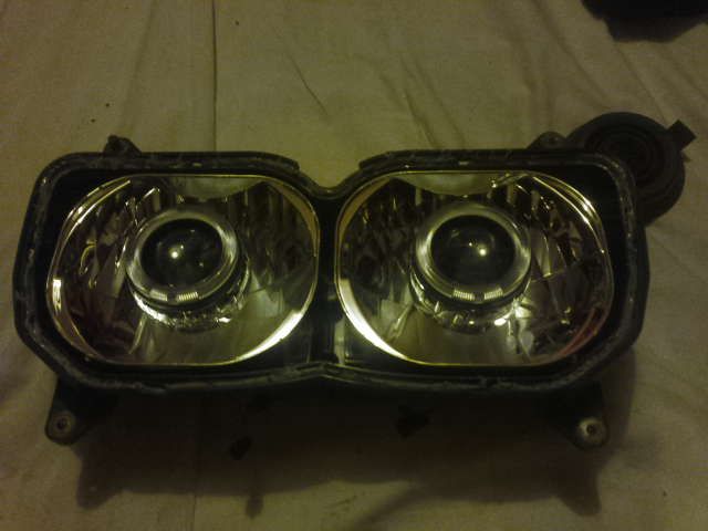

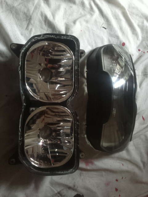

So I split the headlamp with the oven (no I didn't drop the oven on it). I will add a word of warning this can (and nearly did) totally feck up your headlamp, plastic doesn't like getting too hot...
lens split from body
projectors in
reflectors painted black (i did say i like black!!!)

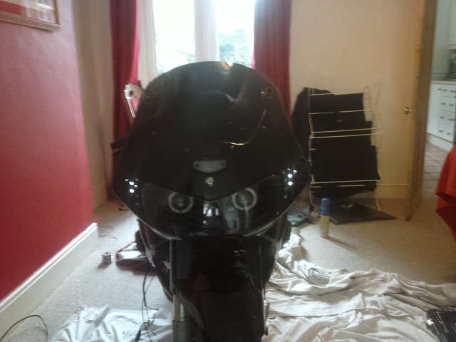

lens back on... I will admit this was a ball ache getting the lens back on, patience is definitely your friend (or should that be fiend?)

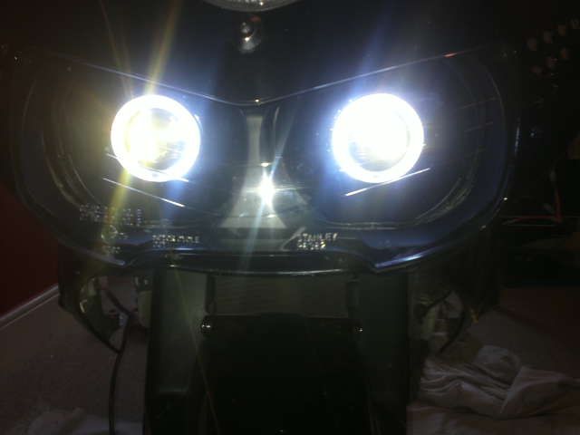

it's on
and it works

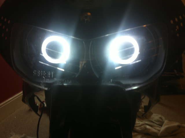

and then just the angel eyes (side lights)

for my next trick it will be billet rear sets (not off the shelf but my own design)

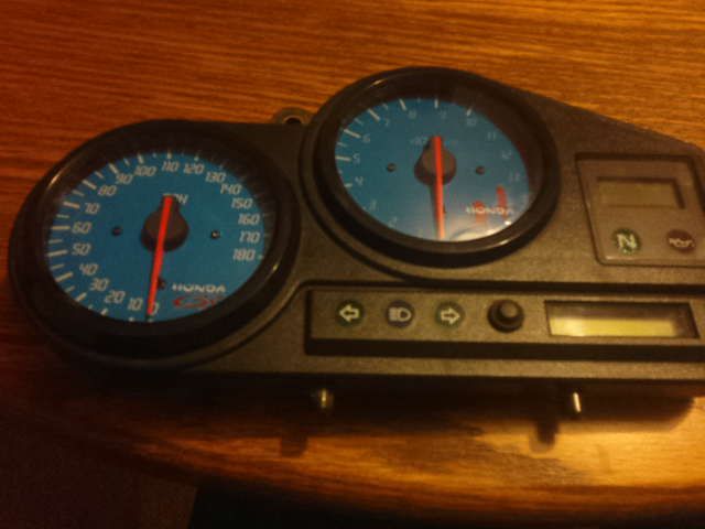

Where did you get the blue dials from? fancy changing mine at some point
Re: Well it all sorta started standard like...
Post by 89forever on Sun 17 Mar 2013, 07:13
clive1286 wrote:Where did you get the blue dials from? fancy changing mine at some point
good old Ebay... they were just a quick change to brighten the area until I finish doing the F4I dash swap

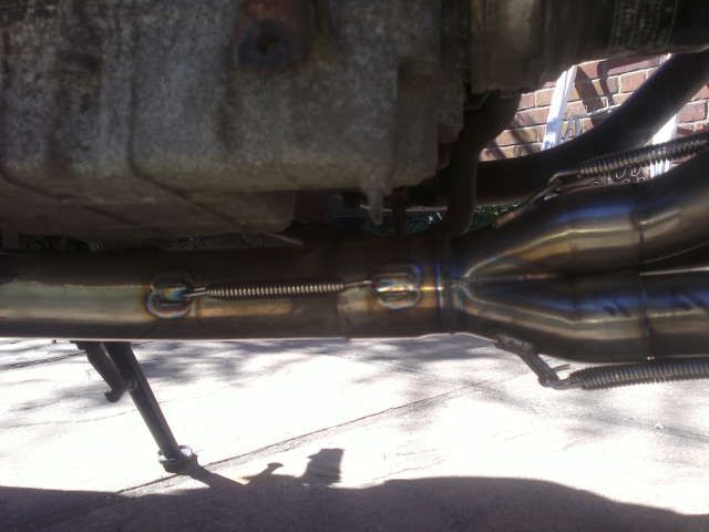

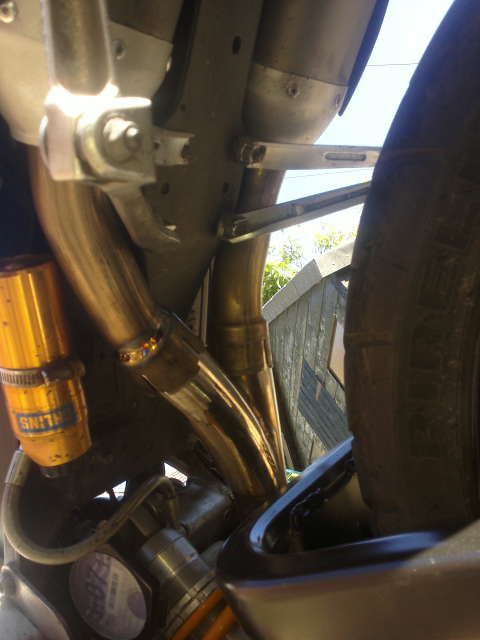

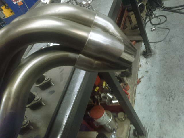

Headers, cans and certain bits for the exhaust have already been addressed...
Today was all about the collector from the headers and nearly got it all done.

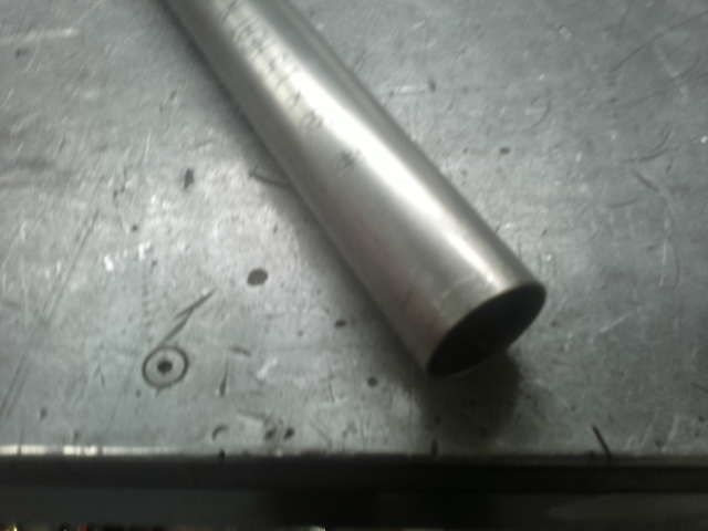

So I started with a plain piece of 38.1mm OD tubing (1.5mm WT)
Made some cuts
got a bit tacky and joined them together lol
and voila 1 collector
nice smooth transitions
and fitted to the headers
Tomorrow
see's the new headers fitted to the bike, along with the cans (again)
and I get to make the mid section and hopefully get it done (complete
like!!!)

Well I got as far as finishing the collector, added a swaged slip joint to the collector.
I did a trial fit of the headers and all is good... managed to remove all
the studs and nuts without snapping any, 2 remained studs in
the head, so will need to spend a little time getting them out without
snapping them...
I am going to replace the stupid Honda studs with
stock M8 exhaust studs, what a stupid idea having an M8 one side and
what looks to be an M7??? on the other...
All Titanium of course Smile
Oh and I don't think I showed my lasered header flanges?
Slowly getting there...

Post by 89forever on Tue 16 Apr 2013, 21:54
Well the exhaust is slooooooooooowly coming on but I have a small update I been measuring for a (very) lightweight bracket for
the F4i dash install and came up with this, had it water jetted from 4mm thick
6081T6 aluminium so it will anodise nicely (yes it will be black) but won't be
sending it off until I have machined all the bits for my rear sets, once I've
finished modelling them on CAD that is
any way a pic?
even though my dash has a face to suit the RRW I am still trying to find
another solution to get a custom colour without a logo.
I may yet try to scan it and print my own at this rate!!!
Nothing else to report other than I bought some nice Titanium studs and nuts for when I have finally got the new headers nailed to the engine for good (then can I go to the nice dyno man please?), good thing is they worked out bloody cheaper than the stupid M8/M7 efforts that Honda do as standard which I was v.pleased about but even if they where 20x more expensive I'd have still got them as I do have a Ti addiction lol...

Post by 89forever on Sat 20 Apr 2013, 16:43
Finally, finally.... FINALLY I can get rid of that awful bloody poxy side can that I have hated more than all the chrome on my bike it has been a long day coming
but feels oh so good, am quite giddy haha anyway I am sure you guy's don't want
me waffling (or even know at this stage what I'm on about!!!) on as we all want pics?
Well, we remember where we got to? I finished the collector...
so the headers and collector got fitted along with the exhaust tangs and
springs
and then we have the link pipe tucked up neatly under the sump
up through the swingarm, close but doesn't rub, even when warm, I attached
the new link pipe to the original mounting so it is very secure and doesn't
move.
and flows into another collector (y pipe?) where it attached to the R1
can's
just need to polish the pipe and remove machining marks etc, then just 2
clamps to buy for the cans and all is done. It sounds a little louder than what
it was ( )
the neighbours are gonna love it at 5am hahaha and it spits and bangs more so on
the overrun than before so def needs a session on the rollers to optimise
everything but all in all job's a good 'un!!!
love it...
