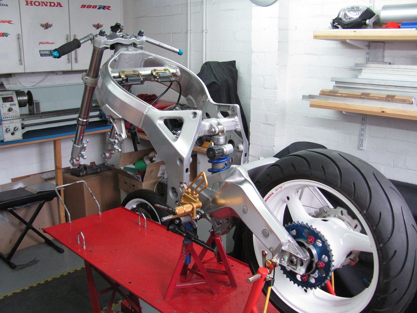

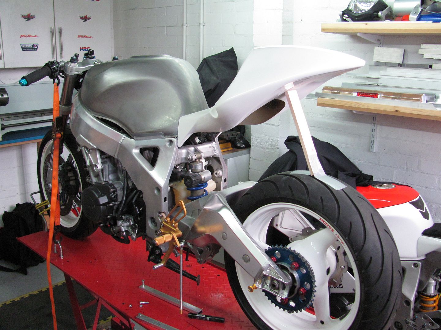

Posting for chimpy.
Building her a blade from leftovers

Alls looking good there Mr C, whats the colour scheme in mind?.
look! Re: chimpy's new blade
Post by Chimpy on Fri 15 Jun 2012, 22:58
chilli wrote:Alls looking good there Mr C, whats the colour scheme in mind?.
blue and white with red belly pan chilli

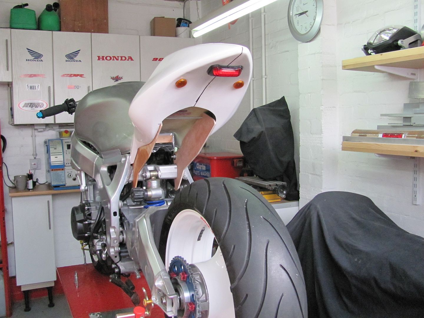

Post by cabbie on Sat 16 Jun 2012, 17:03

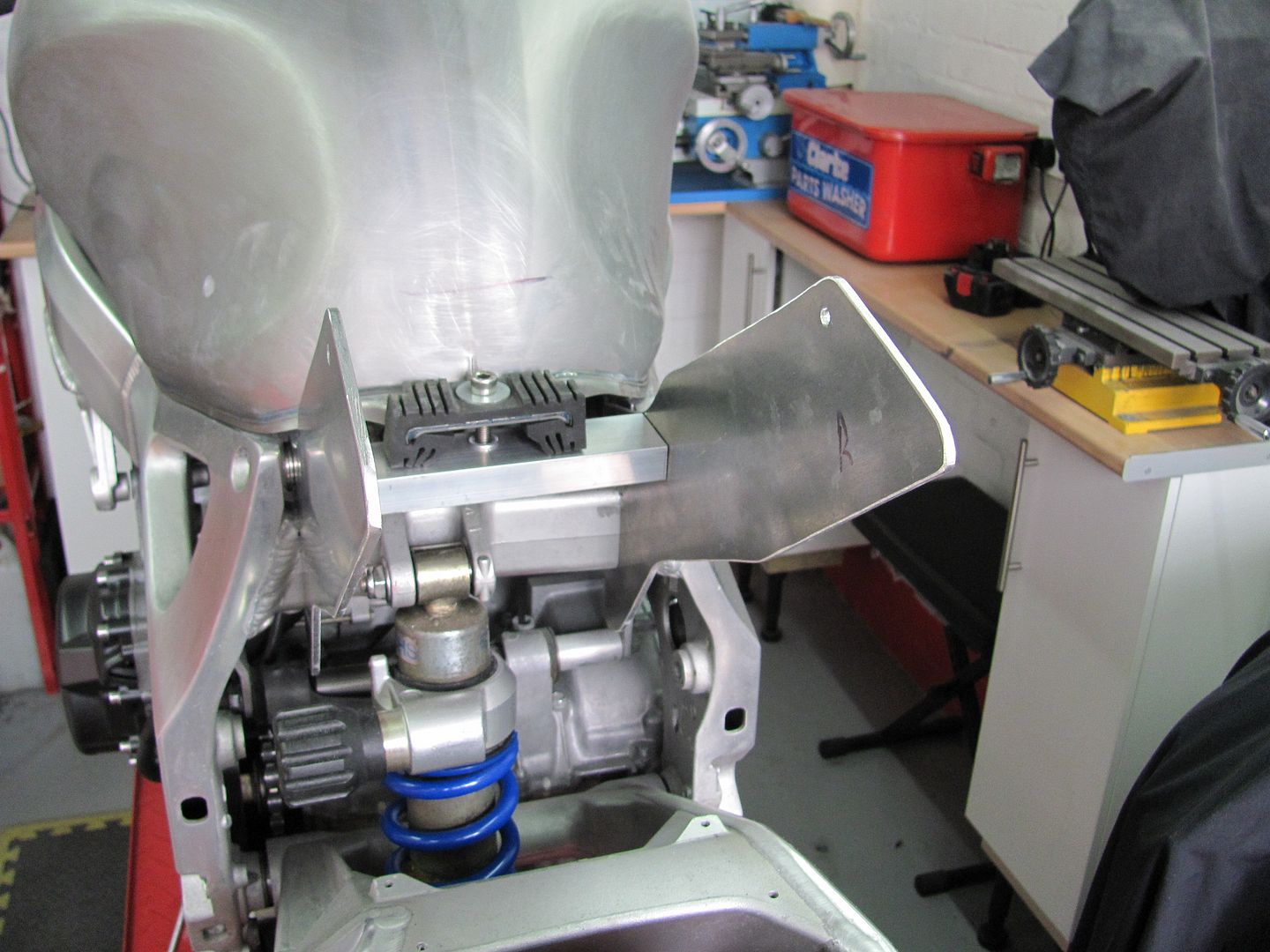

Update,
I made the subframe plates
And chimpy marked out, drilled the holes and fitted the lights, all by herself! cleaver chimpy Smile

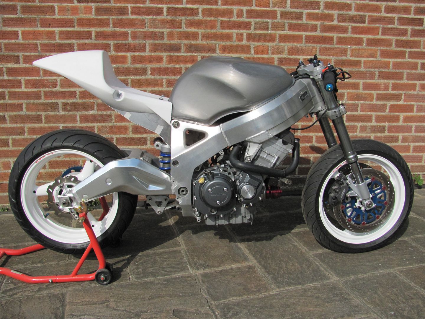

no mate, will have fairings, it's my fair weather bike and back up transport, my other Blade is a 16 year old work horse now

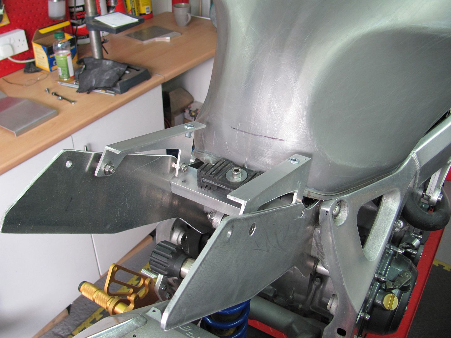

Post by cabbie on Mon 18 Jun 2012, 18:15
Yeah 929 parts.
Got the subframe made up ready for welding tomorrow

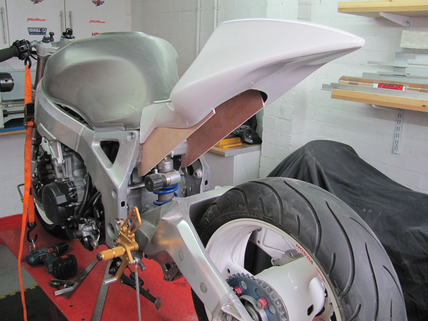

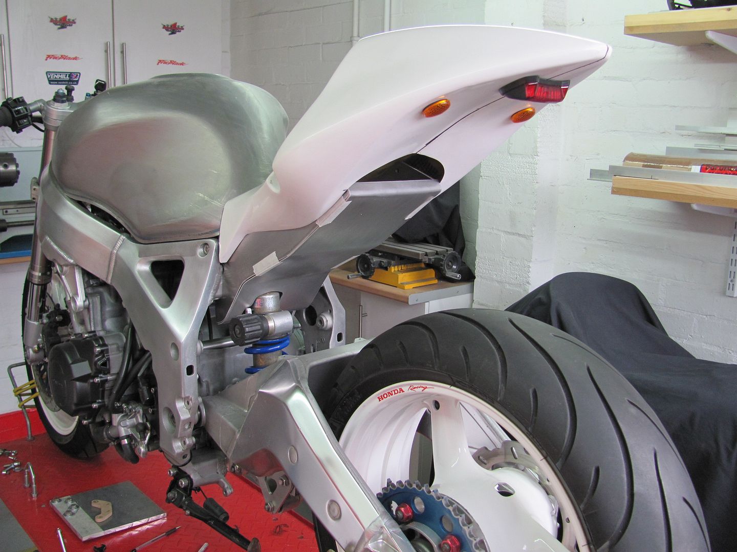

Post by cabbie on Tue 19 Jun 2012, 20:48
Got the seat supports made and fitted
And the side mounts too, seat is now done, just welding to finish tomorrow
The chimp checking to make sure I did a good job Smile

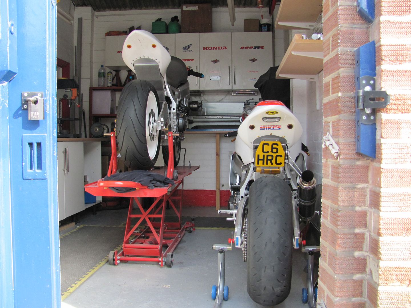

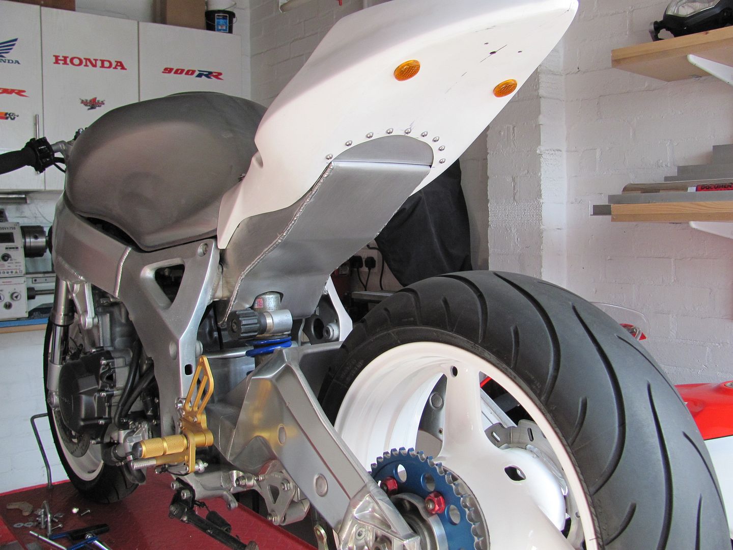

Post by cabbie on Wed 20 Jun 2012, 17:26
Little update
Got the subframe welded up and made the access panel
It's twins!
