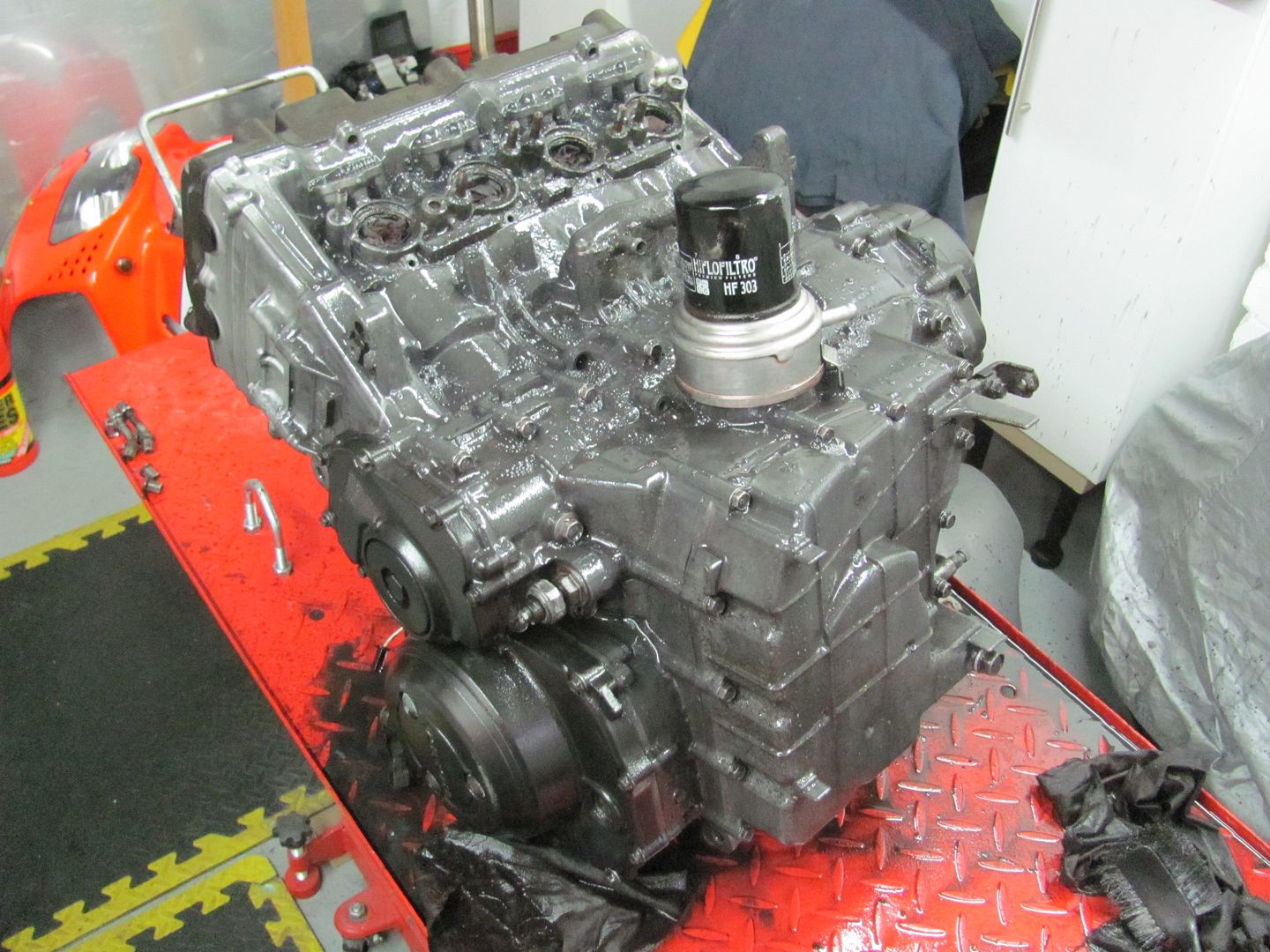

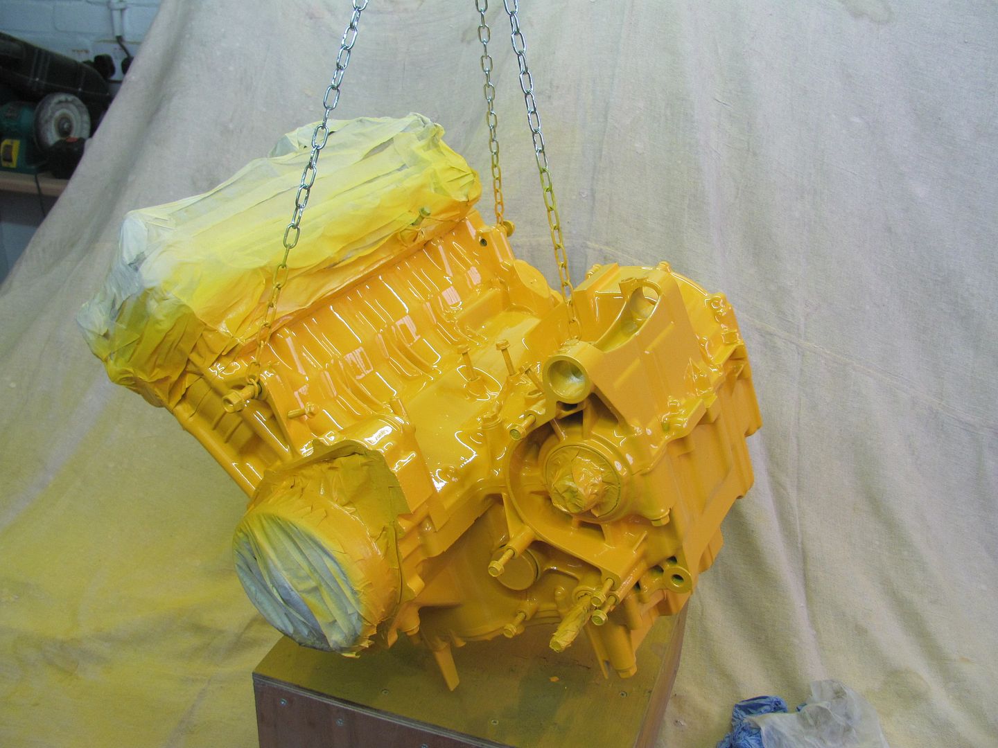

They didn't have a clue, the set up was a joke, I had the engine stripped and inspected by someone that knows about blade turbo's and he said the set up and items used were bollox, IE cheap Chinese copy of a Garrett etc, wrong head gasket, carbs well out, the turbo was set at 13psi! enough to blow the head off, M B Customs has a biblical disclaimer on their site that means they can f**k your engine up and there is nothing you can do about it!, live and learn only 5k down the drain.
So new engine
Acid wash
Paint
Finished
And going back in chassis

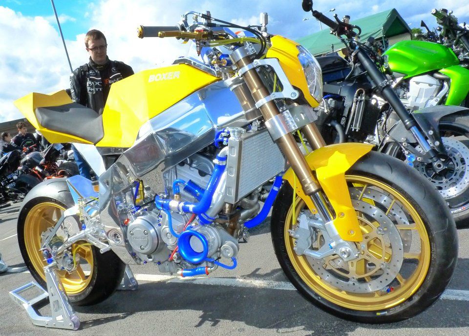

Post by cabbie on Sat 27 Oct 2012, 18:36
At Brent Cross show

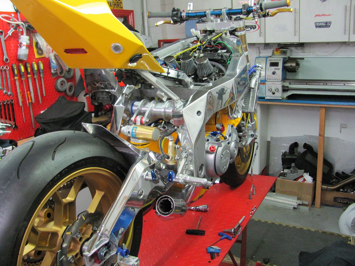

Few build pix
Re: Vid of last years project
Post by cabbie on Sat 27 Oct 2012, 22:37
Post by cabbie on Sat 27 Oct 2012, 22:40
Post by Blade_Hog on Sat 27 Oct 2012, 22:48
To much porn pal

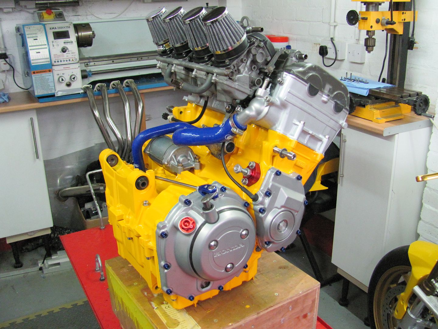

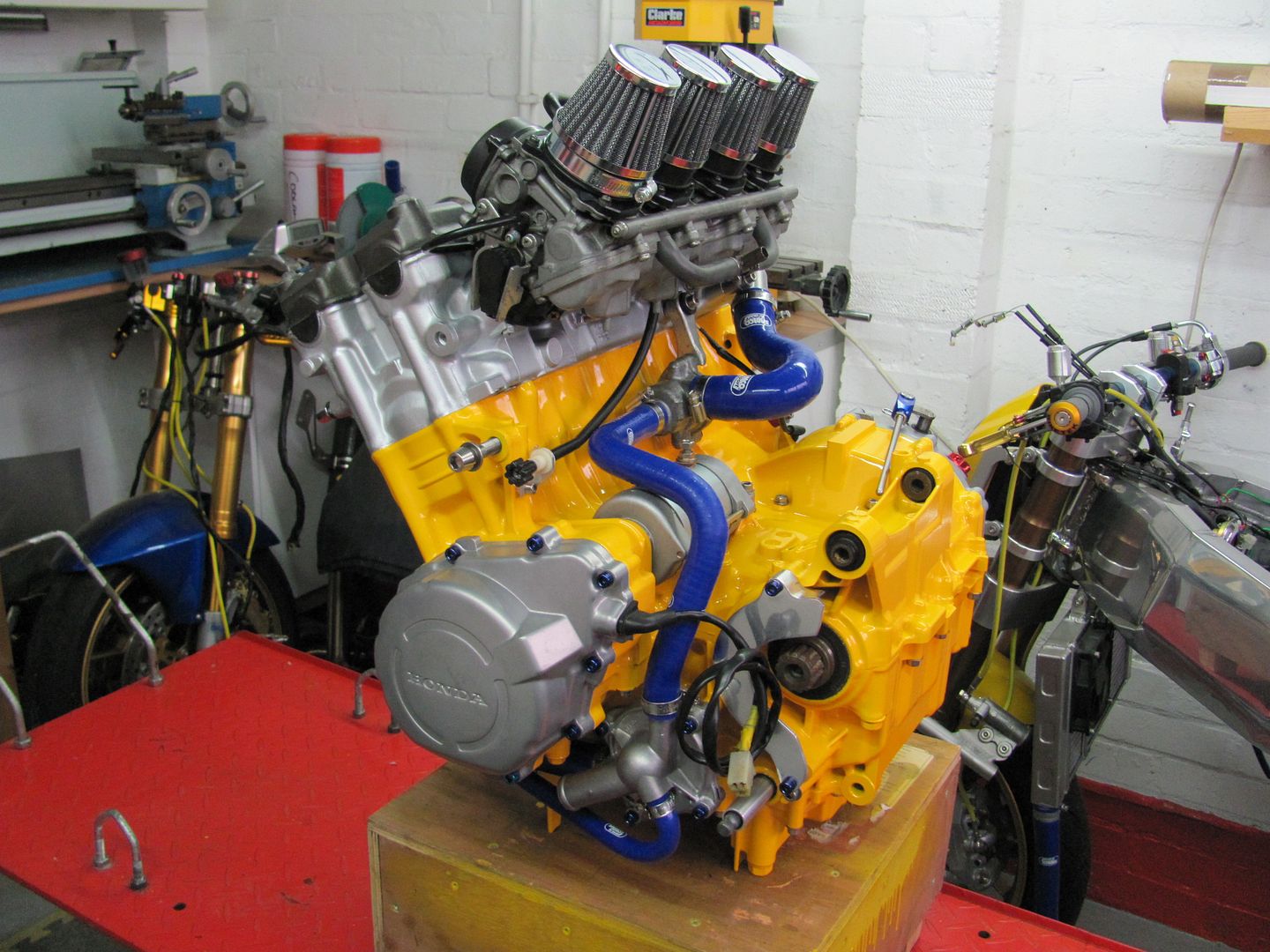

Post by cabbie on Sun 28 Oct 2012, 16:04

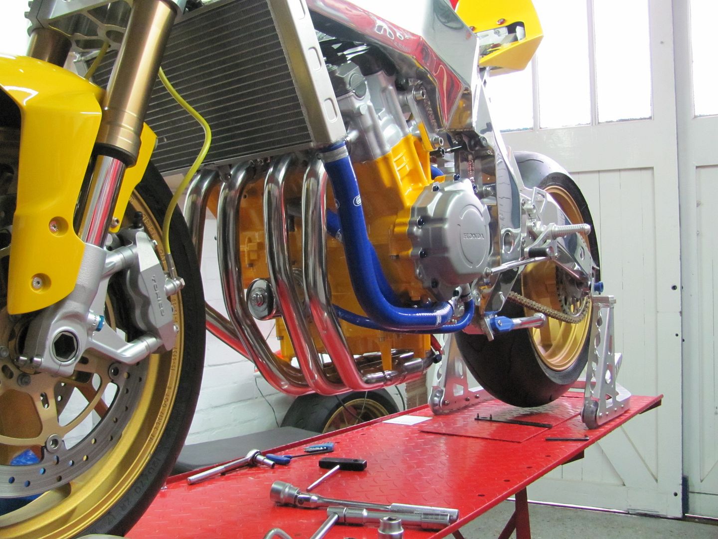

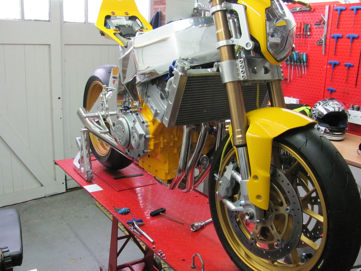

So heres the none turbo version, motor in and headers on, just need to cut and re align the rear section for the racefit can

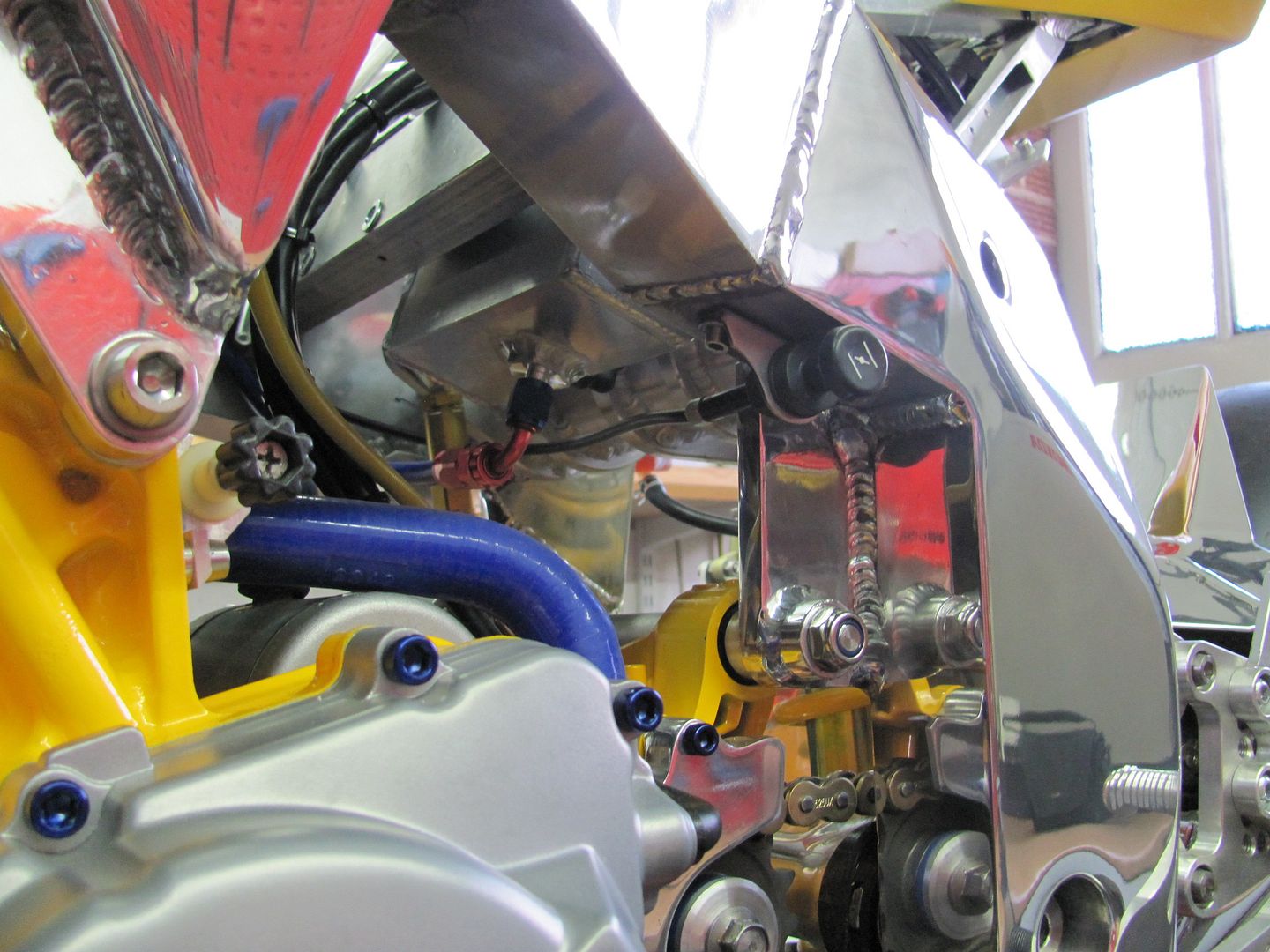

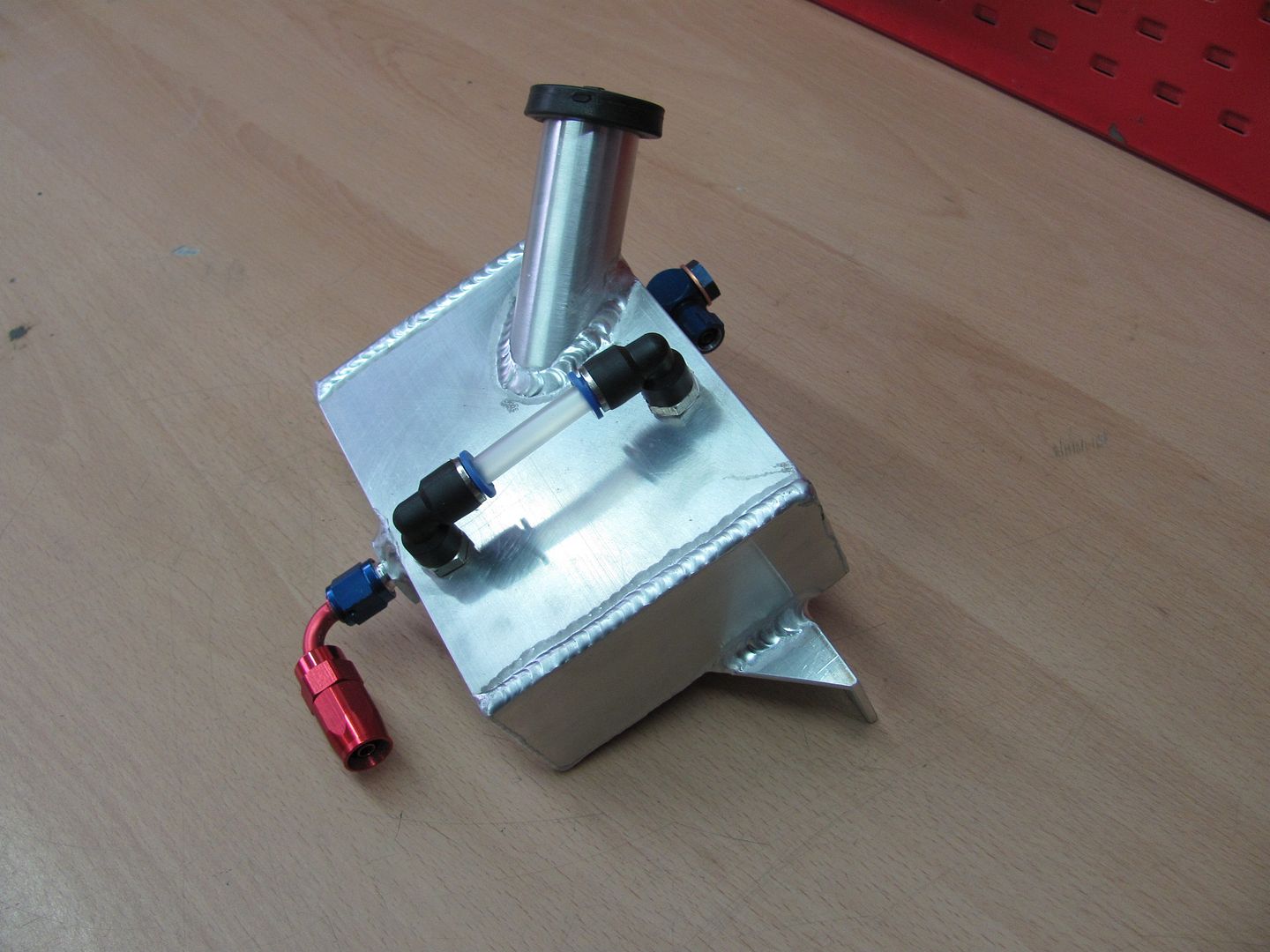

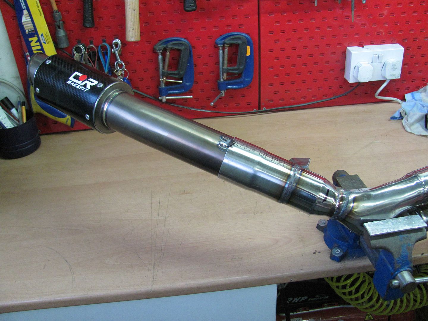

Post by cabbie on Thu 01 Nov 2012, 20:32
So now I'm fitting a normal Zorst the little expansion tank under the swing arm will have to go, here's the new tank I made up
And fitted

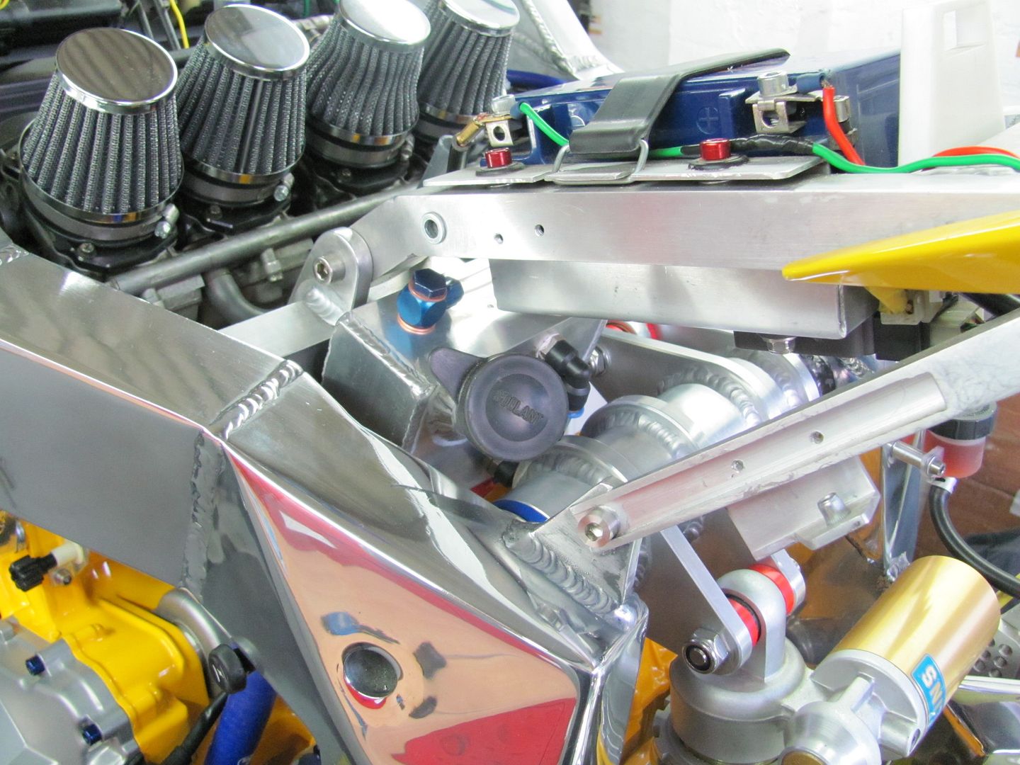

And started modifying the new blade system to take a slip on Racefit can
Post by wes on Thu 01 Nov 2012, 21:22
That racefit is going to sound proper crazy and it looks the business. Also is there any benefit from having the separate air filters? cheers wes
Post by cabbie on Thu 01 Nov 2012, 21:31
wes wrote:That racefit is going to sound proper crazy and it looks the business. Also is there any benefit from having the separate air filters? cheers wes
I can't fit a standard air box under the tank, the turbo plenium was much smaller so have no choice but to fit cones
