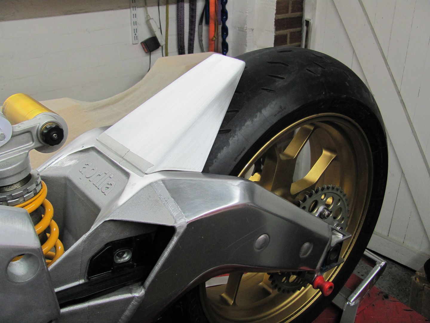

Made a start on the seat unit pattern

More work on the seat pattern, tapped up to check style and shape is as wanted.

Post by cabbie on Thu 22 Nov 2012, 20:57
Seat taking shape

Post by cabbie on Sun 25 Nov 2012, 16:13
More progress on the seat pattern
