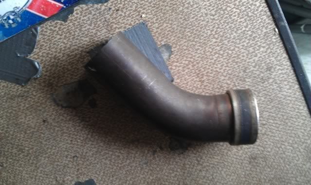

I marked the vertical section of the headers 150mm from the collars and started cutting the tops off.
This is no4 header top section.
Will do a bit more tomorrow before work.:D:D

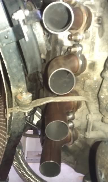

Managed to cut and file the other three stubs and fit em to the RRW engine this morning;
The view from underneath;
Next job is to make a bracket to support the RR8 exhaust in the best position while I make and fit the 38mm spacers into the gaps!
