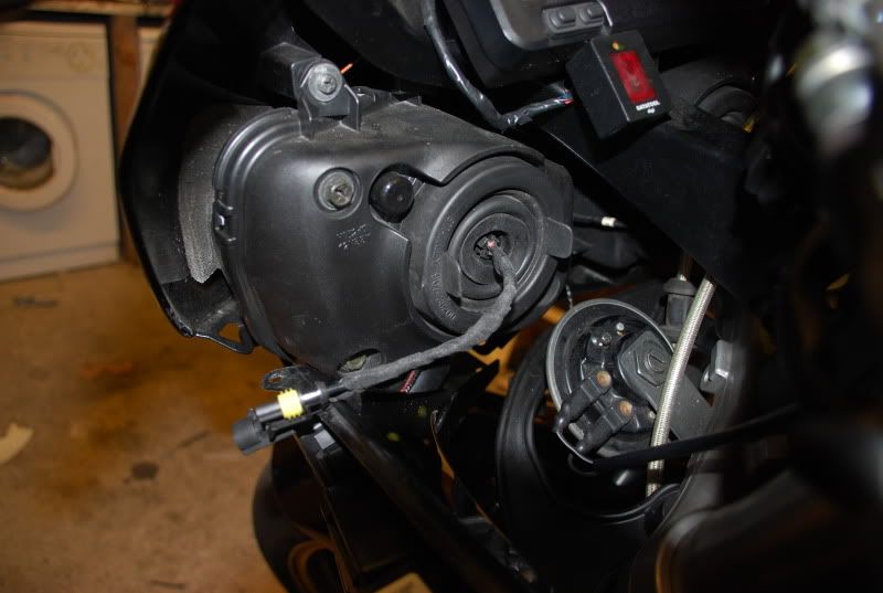

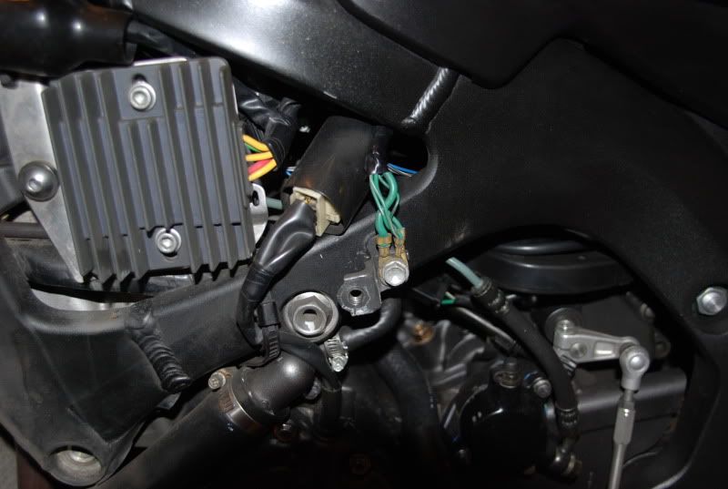

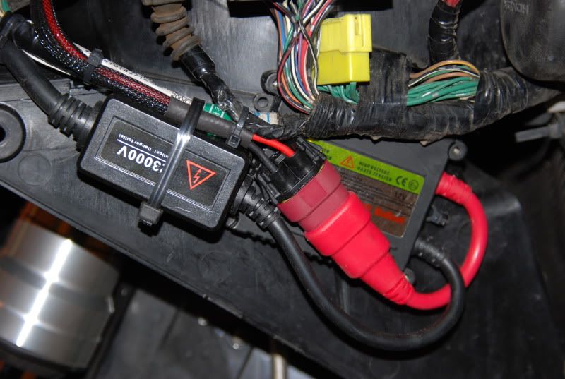

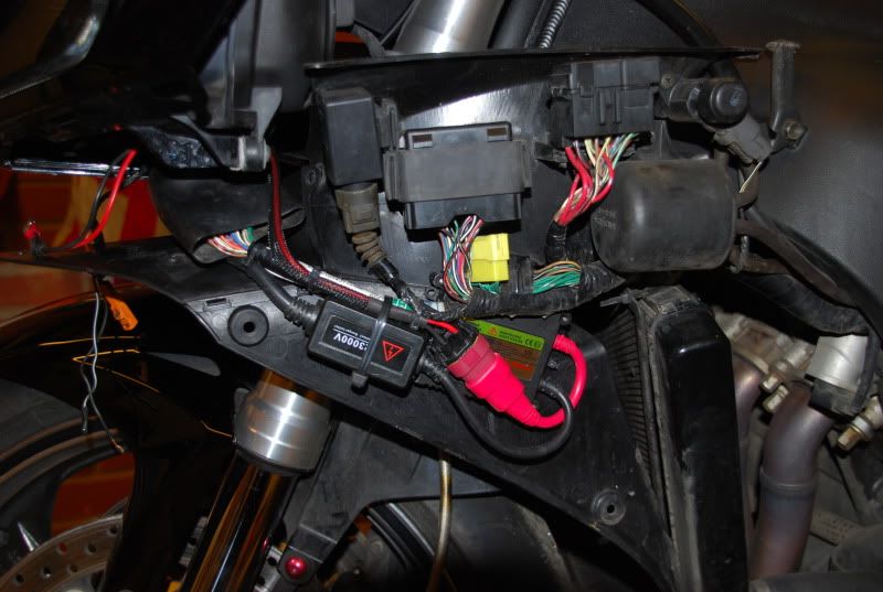

Just a few pics of fitting .
New bulb taped n fitted in Dip Beam side
Left side panel removed and Slim Ballast and wiring fitted (well most of it )
And just for everyones information.........Here are a load of Earth wires just incase anyone wants to know,also if you look near the HID ballast you,ll find a YELLOW plug...........More earths that Mr Honda uses for fault finding,they corrod like hell so keep an eye on them
The only problem I,ve encounted is that the HID fires up when the ignition is switched on and then it goes out when cranking the starter,I knew this would be an issue so I,m fitting a little switch to only allow the HID to fire up once the engine is burbling .
