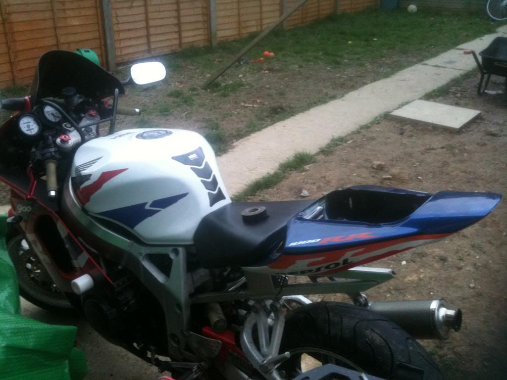

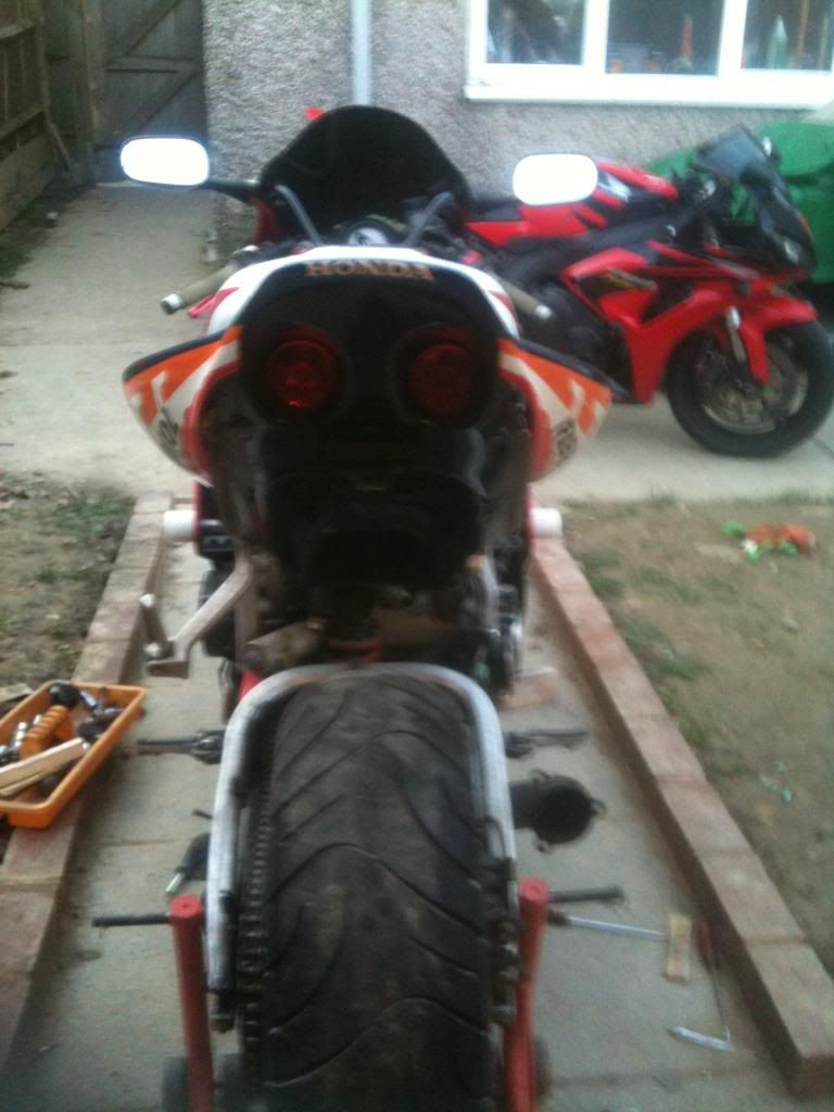

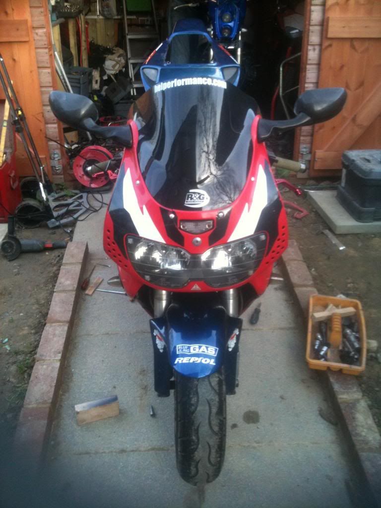

Well now that i am off the road for a bit due to having a op on my sholder i thought now is the time to get the blade sorted.So started today after pickin up the seat unit from Andy (Cove),thanks mate hope the move works out ok, any way was going to leave it till sholder was a bit better but then thought stuff it lets get on with it got the old tail unit and subframe of and set about chopping a spare subframeto get the 04 one to fit but then after fitting it to the bike the seat unit sat way to low so tomorrow i am going to set about chopping the subframe a bit more till i am happy with it. i dont have much free cash at the mo so its all
going to be done on a budget of not a lot but i am sure i will get there with it as it aint going back on the road till its all done. I have a few bits still to find like undertray and seat cowl so if any one has any of the two feel free to drop me a pm,anyway here are a few photos to be going on with will post up more as i go

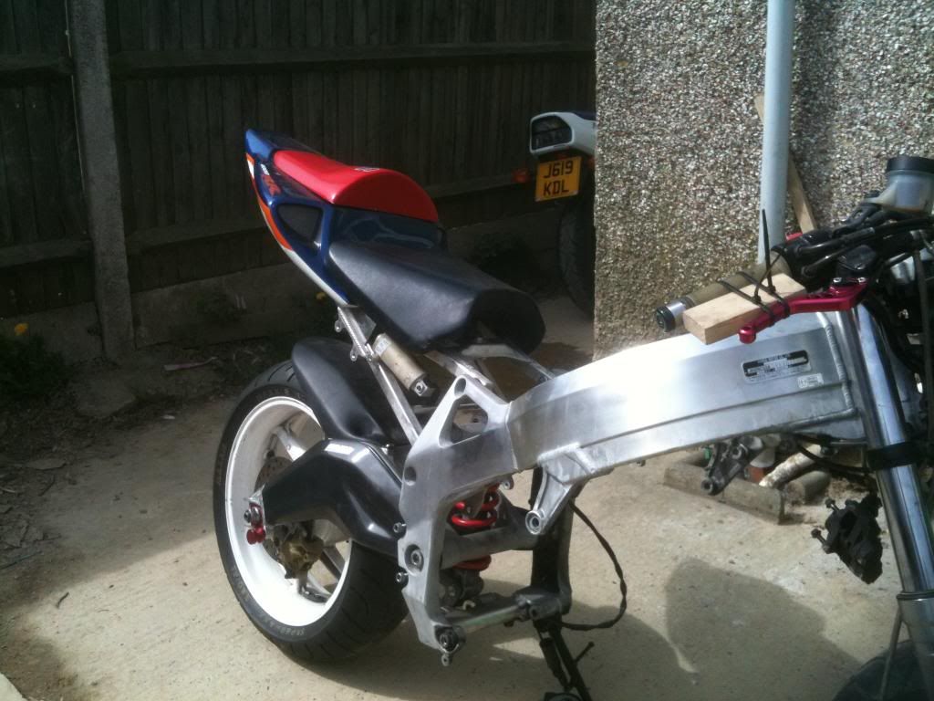

Post by scotty80 on Fri 01 Apr 2011, 22:40

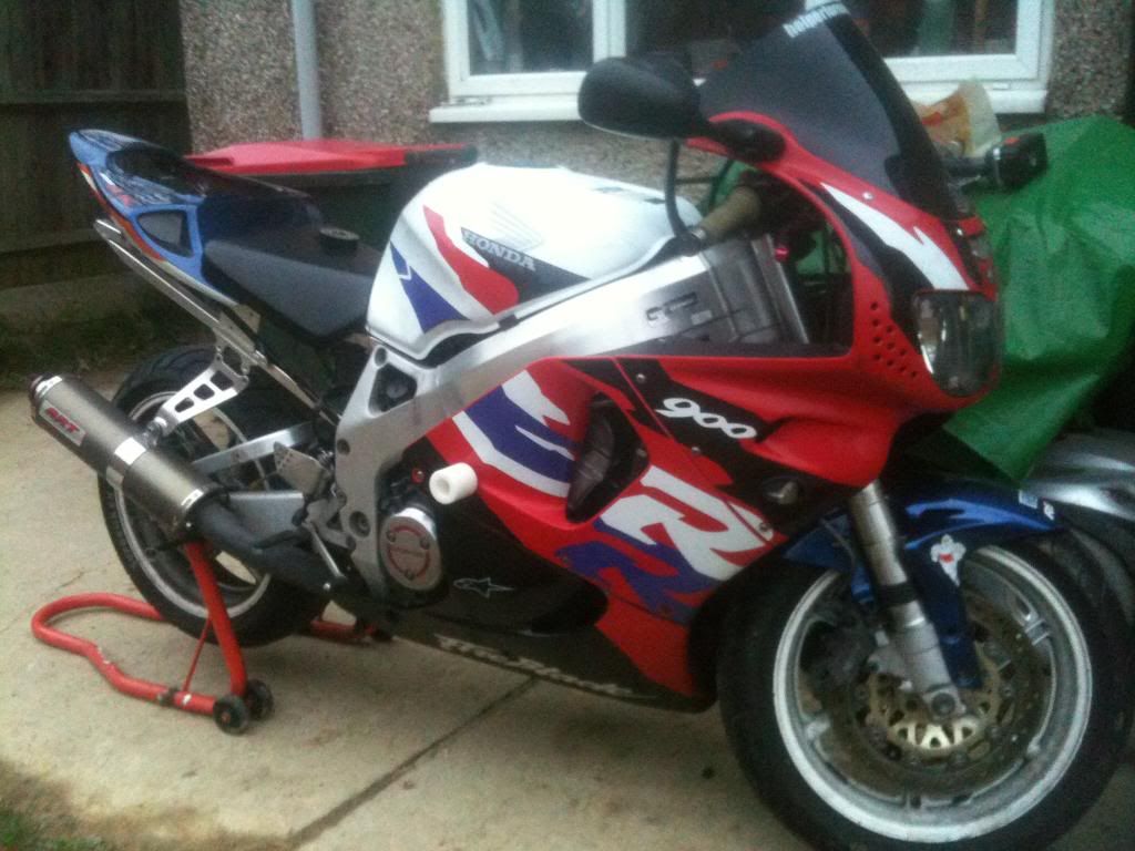

Well got a little bit done today sorted the subframe out just got to make some proper brackets to mount the seat unit to then get it welded then modify the gsxr 1000 undertray to fit sort out the battery box.
got a dilema do i paint the rest of the body work the same as the repsol bits thats on it or do the seat unit and front fender to match how it is now

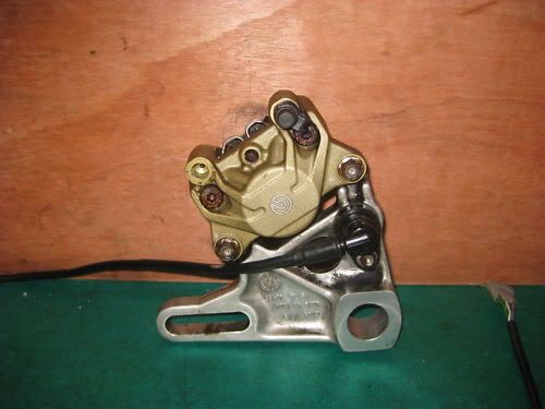

Have just bought a 04 rsv swing arm rear caliper and the bloke has gave me new caliper bolts to and carbon swing arm covers well happy andn cheep to witch is good

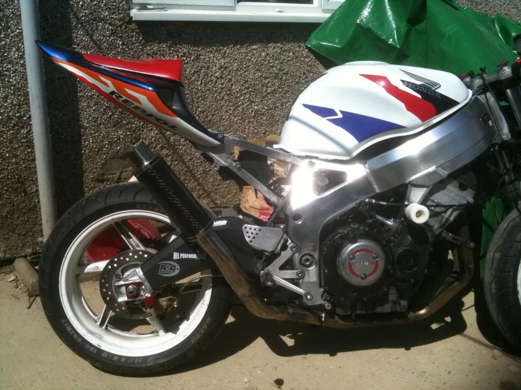

Post by scotty80 on Sat 16 Apr 2011, 20:14

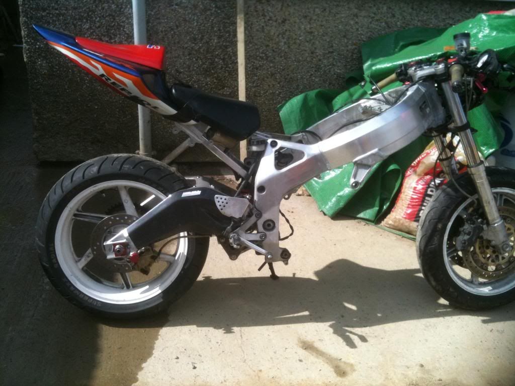

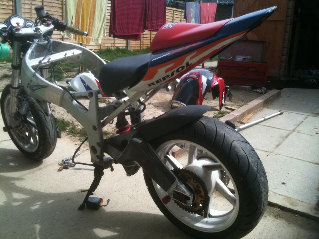

well here is some pics of the frame with the rsv swinger in big thanks to cabbie for all your help ignore the hugger it looks crap

Post by danidge on Fri 22 Apr 2011, 11:40
does that rsv swinger fit straight in with no mods?
Male Age : 28
Re: 04 1000 rr seat unit and rsv swing arm onto rrv

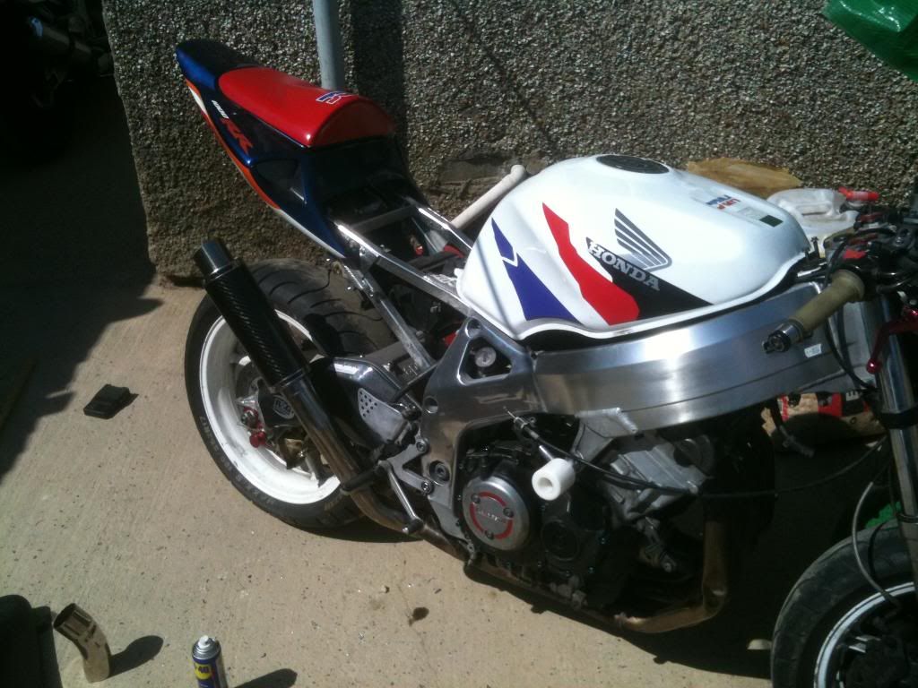

Post by scotty80 on Fri 22 Apr 2011, 15:36

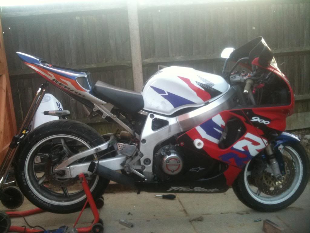

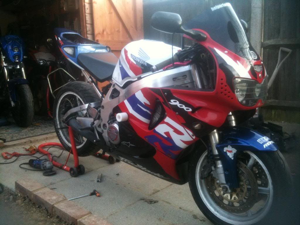

Well heres what i got done today made up a new link pipe and can and got the seat unit secured to subframe should have it all ready to go tomorow if i can get my hands on a soft link for the chain
Post by scotty80 on Fri 22 Apr 2011, 15:37
danidge wrote:does that rsv swinger fit straight in with no mods?
no mate you have to shave a bit off the right hand side of the frame to get it to go in
Post by danidge on Fri 22 Apr 2011, 15:44
oh right, i only ask because i thought i saw somewhere else that they go straight in. doesn't seem too much to do tho Smile

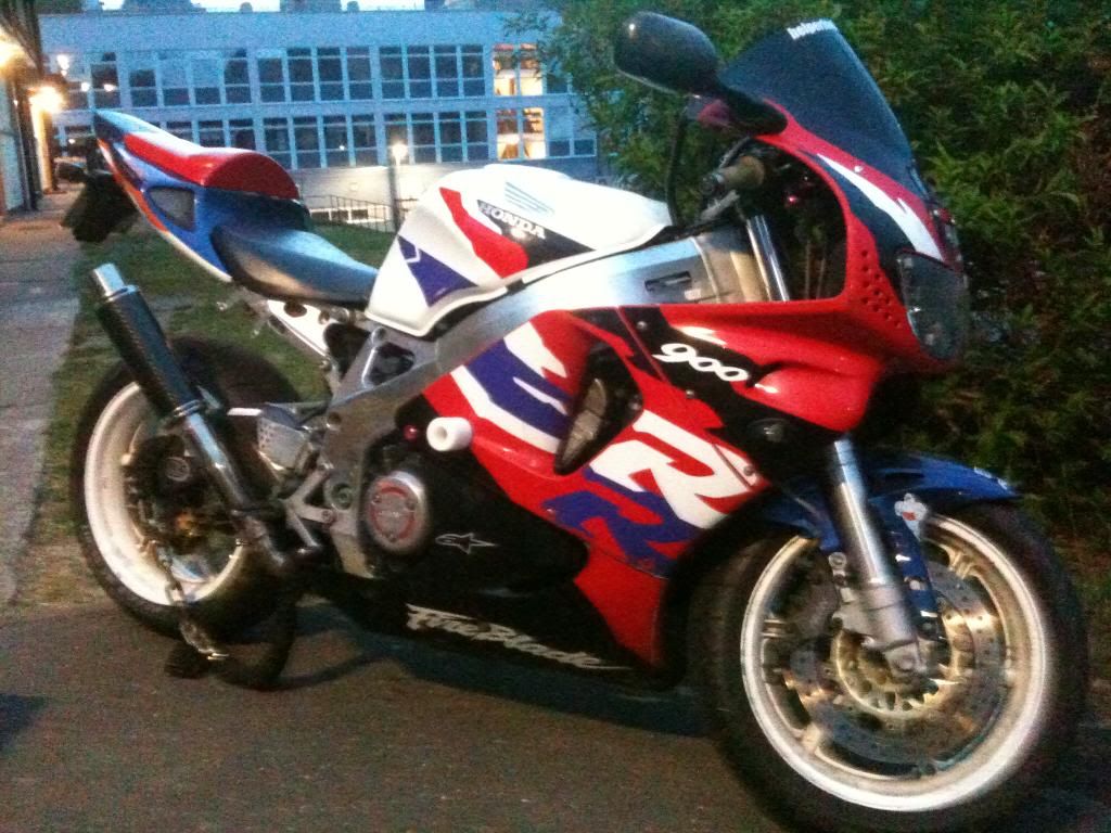

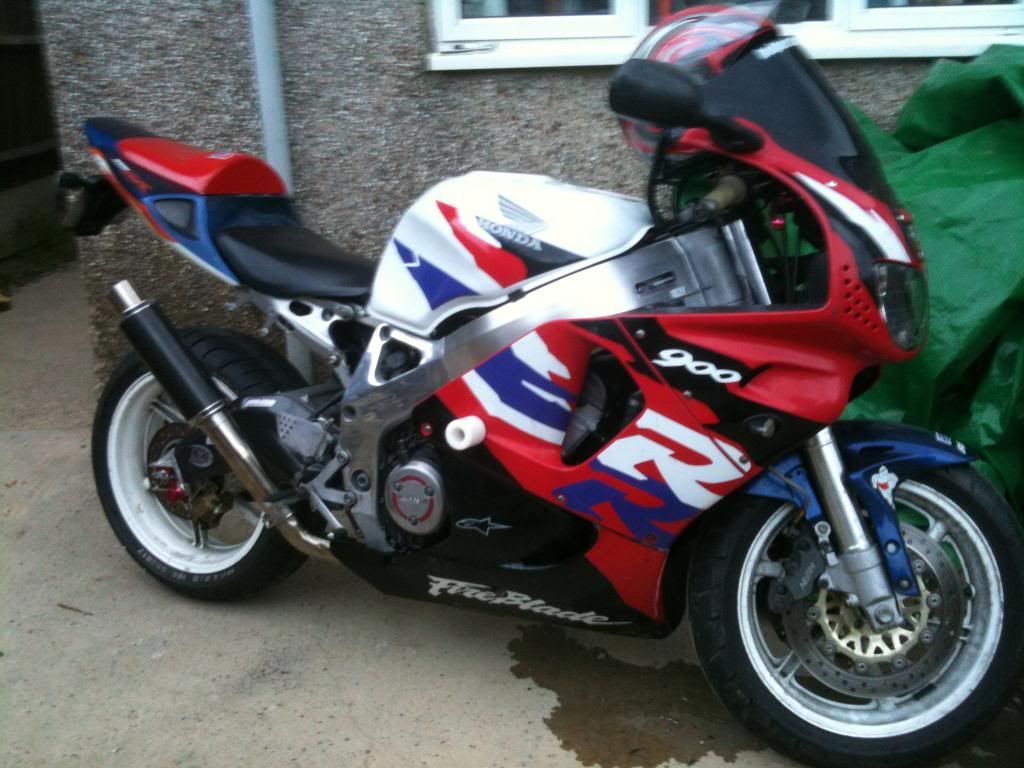

Post by scotty80 on Sat 07 May 2011, 21:27
Well it is done for the time being till i can aford to paint it but at least its on the road,got to do somthing to the exhaust as its oh my god LOUD

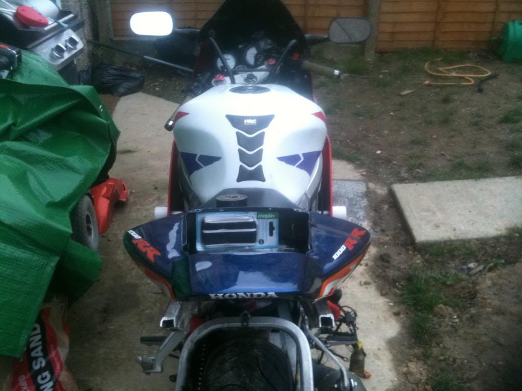

Post by Cove on Sat 07 May 2011, 22:32

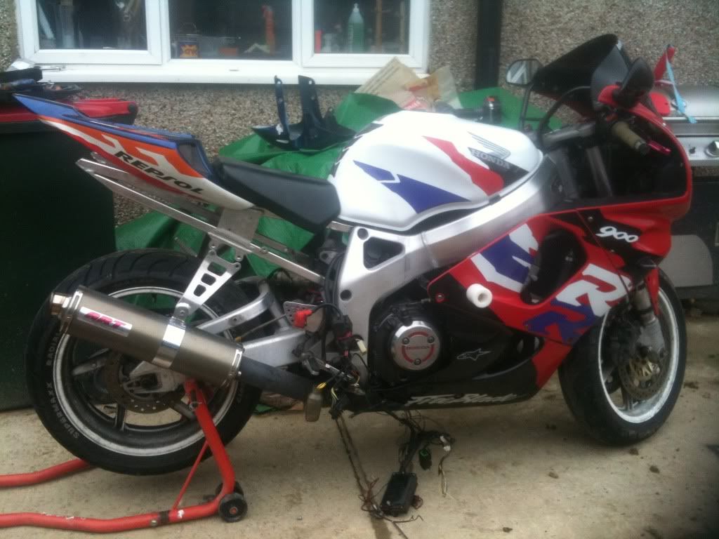

What have you done with the battery and all the electrics george?
Post by scotty80 on Sat 07 May 2011, 22:39
Cove wrote:What have you done with the battery and all the electrics george?
I used the under tray that come with the subframe battery fits ok got to have a bit of a sort out with the loom and bits but its all in ok for the moment and will do a proper job when i paint it

Mine looks messy as anything at the moment was thinking of extending my positive an negative battery lead and putting it under pillion seat, and leaving reg rec cdi and starter solenoid to where it is dont fancy chopping the loom about.

Post by Guest on Sat 07 May 2011, 23:32
Can make you a baffle for that can George? Just need accurate dimensions???
Post by scotty80 on Sat 07 May 2011, 23:36
megawatt wrote:Can make you a baffle for that can George? Just need accurate dimensions???
i am going to try and do something with it tomorrow as it has one in it but its shit,will be comin down you way next weekend if you are about??
