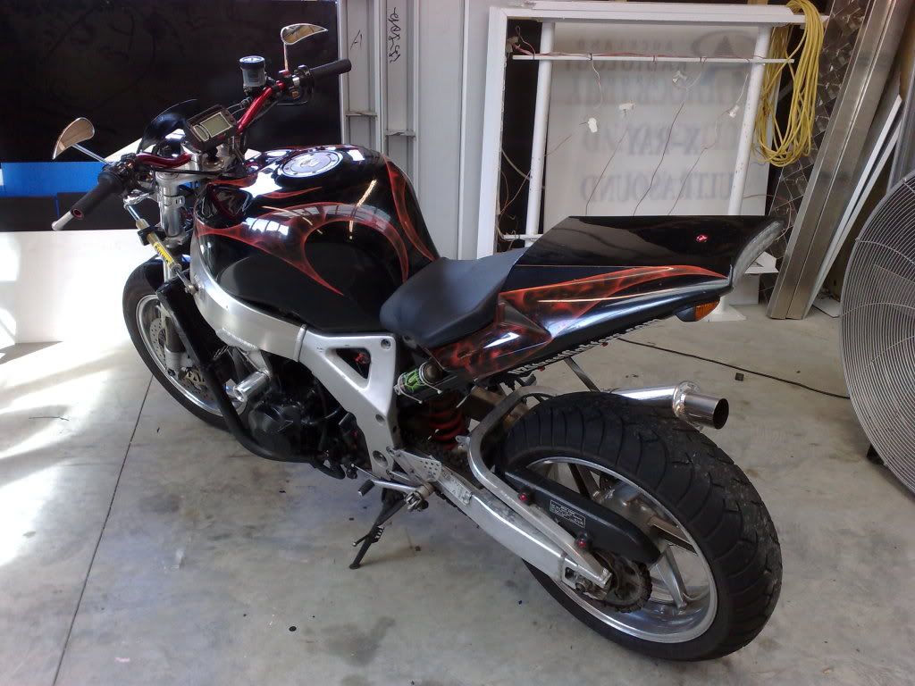

Re: Project Very Slow
Post by Wee Al B on Sat 12 Jun 2010, 15:37
No bits to put on so thought I'd just take some more off Laughing Still can't decide what to do with the tail pullhaur2

Post by Teebagga on Sun 20 Jun 2010, 08:03
Maybe a R1 like this? I had one on mine that look f@#kin mint and would look nice over the single sider!

Post by Wee Al B on Sun 20 Jun 2010, 10:24
R1 was my original plan to be honest. Mate's got a spare set if plastics so really should get them and give them a try
Post by Wee Al B on Sun 20 Jun 2010, 14:32
Though quite like this tail from Fight Machines, though in a more subtle colour Laughing

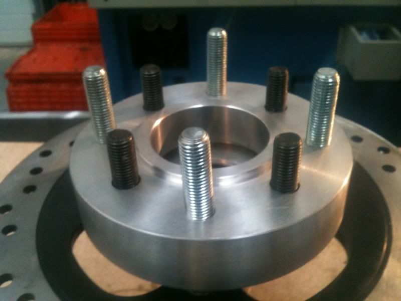

Post by Exile on Sat 03 Jul 2010, 12:36
Aint been on for ages lads
Ive had pooter problems
I got a company in Kent called CDF RACING to do me a hubcentric spacer for 65
Its 30mm with a 75mm lip to go over the VFR hub and a 73.5 outer lip to locate the wheel on the spacer
My wheel has 2 stud patterns 4x100 and 4x105 , so i got the spacer made with built in studs so i can use all 8 holes in the wheel

Post by Wee Al B on Sat 03 Jul 2010, 18:01
That's what mine should look like apart from the extra studs lol
Planned on making it myself (with a bit of guidance) but the lathe in our workshop was too small for the diameter.
Fall back plan was to get one of the machine tool operators at work to make one for me. Only cost me the price of material, 25 seeing as I bought two bits, just in case Laughing

Post by Wee Al B on Wed 14 Jul 2010, 16:23
Spacer done and hub refitted today but something ain't right.
All bolted together and the wheels locking up against the swingarm, that's not in the plan lol.
Need to scratch my head now and figure out what's wrong.

Post by Wee Al B on Wed 14 Jul 2010, 20:33
Still head scratching.
Spacer's the rights size and the wheel is definitely a 7x17 and I'm pretty certain the hub build up was ok as I can't find any spare bits.
Think I'll be stripping the hub again to double check, arse.

Post by Exile on Fri 16 Jul 2010, 12:49
Is the wheel hitting the inside of the arm ???
If so you will need to get Mr Grinder out and just flatten back the seem that runs down the middle of the inside of the arm
The off set of the wheel needs to be 40mm, any thing less and the wheel will touch the arm aswell

Post by Exile on Fri 16 Jul 2010, 12:52
Ahhhh just thought
If the wheels not touching but the hub is locked up
Make sure that you have fitted the thin washer/spacer behind the sprocket carrier

Post by Wee Al B on Fri 16 Jul 2010, 13:18
It is the wheel that's touching. I'm certain the wheel offset is 40mm but I'll double check when I get home and also check the alignment with the front.
I don't remember seeing a seam on the arm Exile but I'll have a look for that too.

Post by Wee Al B on Fri 16 Jul 2010, 18:15
Everything checked size wise and it's ok.
After another look it's as you said Exile it's hitting where the arm bows out slightly. Got about 5mm clearance above and a bit less below that bit, wasn't expecting the wheel to sit quite as close lol, so looks like a bit if delicate work with the angle grinder is required. Need to be next week when I've got more time.

Post by Wee Al B on Mon 26 Jul 2010, 18:03
Plucked up the courage and got the angle grinder out today and had a go at the swingarm. Wheel now running free and think I can probably get a fag paper between it and the arm Laughing
Just need to get a tyre now and see if there's any more "adjustment" required affraid
