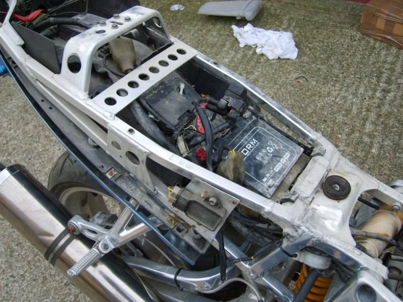

I got this heap of junk last november for a steal...750
It aint been running for 3years but had enough goodys on it to make a viable project
Tuned PDQ motor
Full Akra exhaust system
Ohlins rear shock
PFM calipers and narroow track discs
ABM rear sets
And a gawd awfull paint job

I know the fella that built this and he took it with him when he emigrated out to Spain in 2006. He just left it in his garage to fester

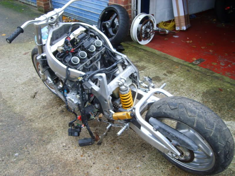

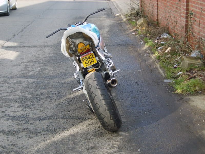

As soon as i offered up the 2006 R6 seat unit i knew it was a wrong'un. So after hours of scratching me head and google image searches i decided on the Triumph 675 race seat unit
This is the first mock up with the VFR arm in wearing Dans Triumph rear wheel half of an old Blade subframe and the compulsory bike builders blocks of wood Laughing

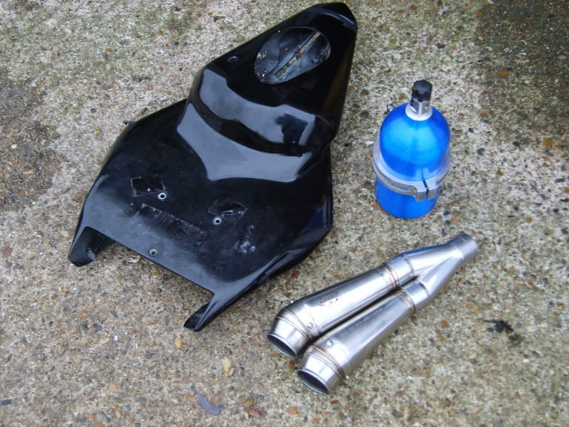

I went back over to the Ducati whell as i thought the Trumpet item abit too spokey. When i offered up the R6 Laser GP can it looked too skiny. But it just so happened that Dan had a GSXR 1000 K7 Remus end can that fitted the bill so we cable tied it up for effect

Dan worked his magic on the subby

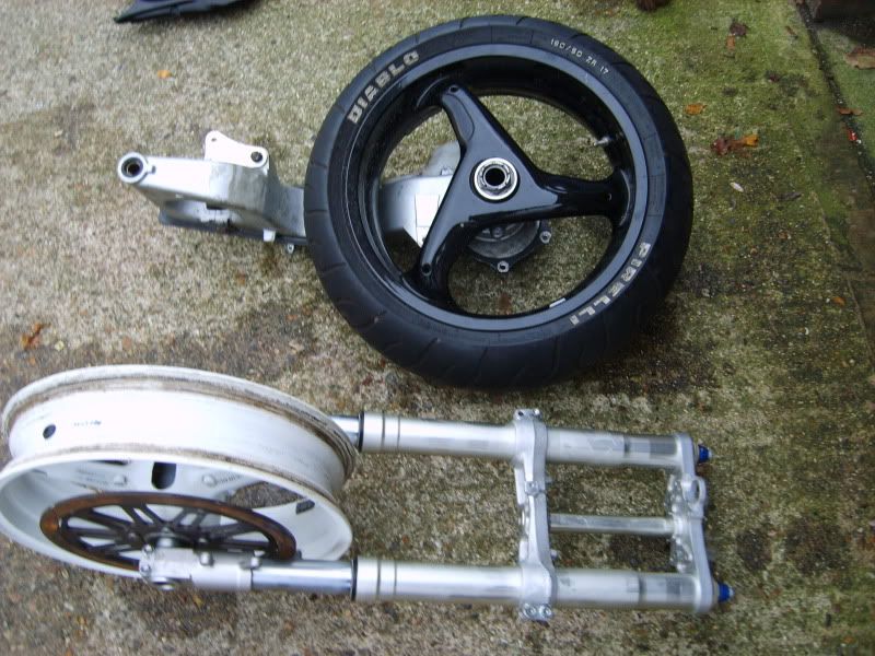

Re: Bitza-Blade
Post by Exile on Fri 19 Mar 2010, 11:11

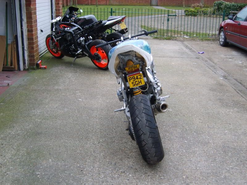

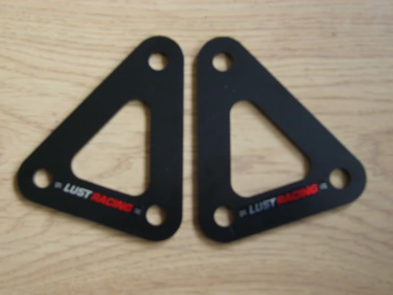

Fitting the VFR arm and using the Blade tie-rods jacks the bike up and make it dangle abit too dangerously on the side stand for me
So i got these beautys
Heres 2 comparison shots
BEFORE
AFTER......back to the more respectable and safer lean angle

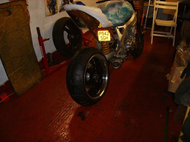

Post by Exile on Sat 20 Mar 2010, 09:20

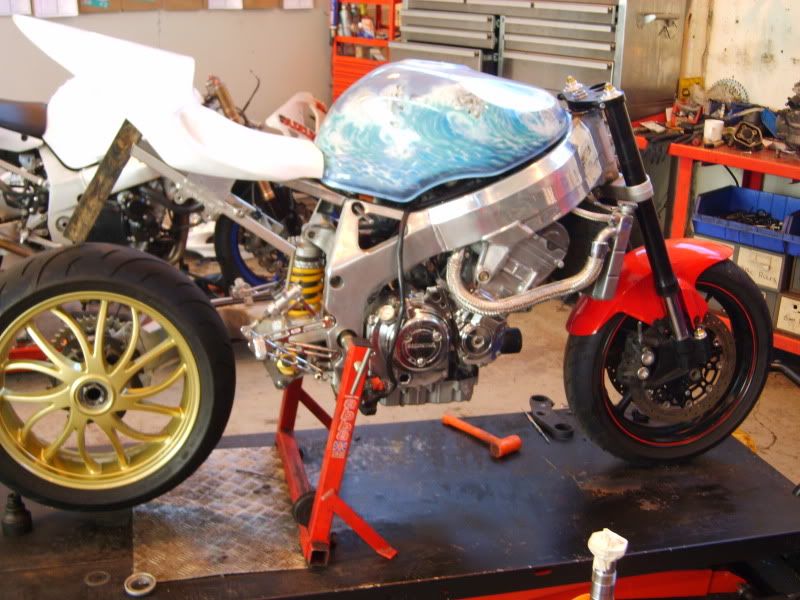

My original plan was to polish the frame and running gear and colour wise was a lairy paintjob based on the JOKER out of Batman but that all changed as soon as i took charge of the headlight mask.
Now the frames going satin black, gloss black bodywork with some airbrushing

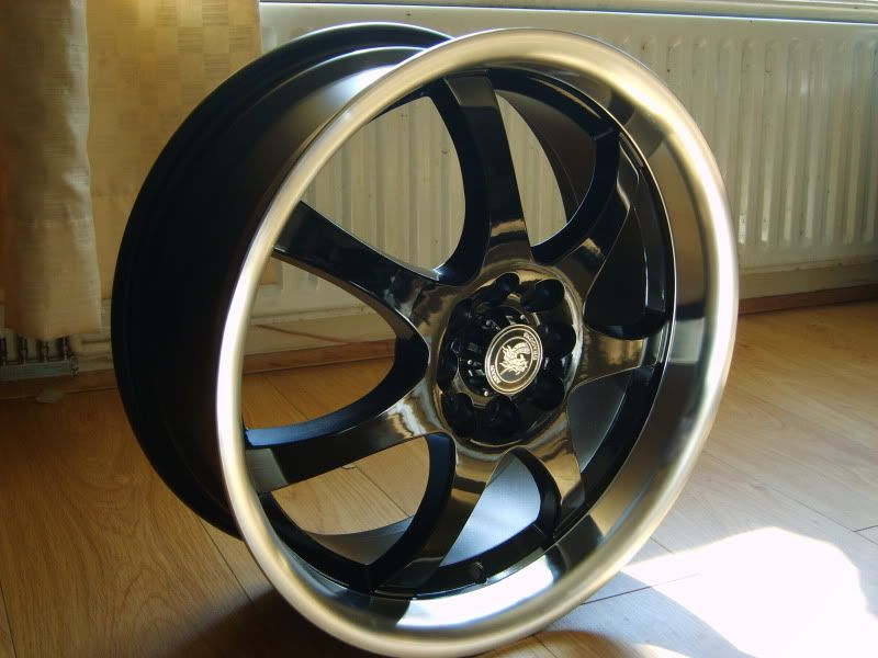

The 180 Ducati back wheel was looking a wee bit Leena Zavaroni to me so......

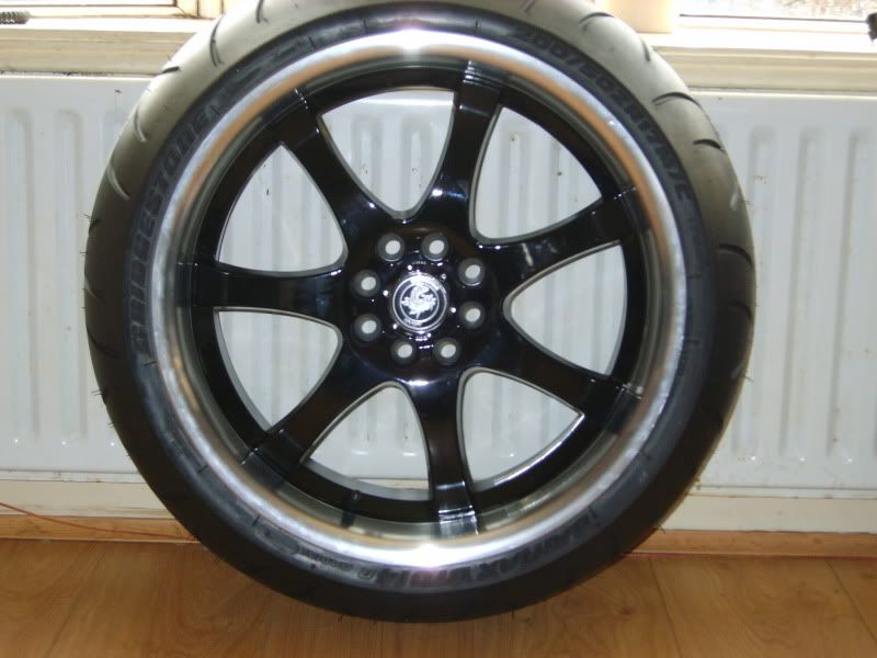

Ive swapped back over to the VFR axel and have bought this 7 x 17 bad boy
Exile
Number of posts : 61
Location : HEE-TROW
My bike(s) : Bitza-blade, GSXR 7/1216, K3 GSXR 1000
Registration date : 2010-03-14
Re: Bitza-Blade

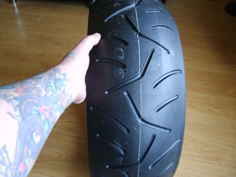

Post by Exile on Sat 20 Mar 2010, 09:25

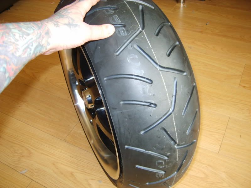

The rim is designed for a 205 to 225 car tyre
Most lads that do the car wheel conversion fit the Metzeler ME880 210 trye which is predomantly for the Hardly Rideable brigade
As i want this to handle plus i have a mint BT014 front tyre in the garage i got hold of this hunk of rubber a BT014 200/50/17

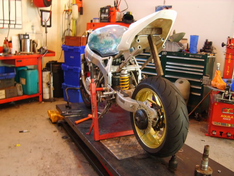

Post by Exile on Sat 20 Mar 2010, 09:30
And heres the fitted item
It took a massif 102 PSI for the bead to pop
The 200 section looks as if it was meant to be

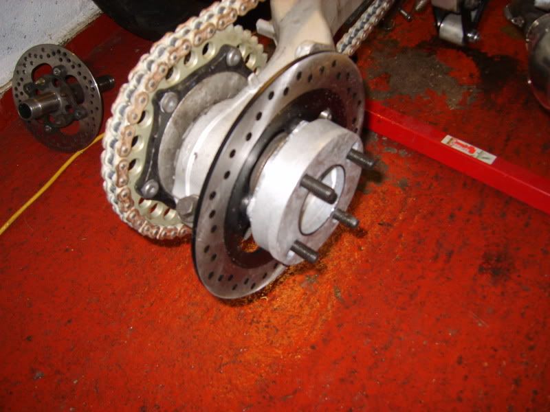

Post by Exile on Sat 20 Mar 2010, 09:35
Gotta say a big thankks to CBRRRT for all the info on doing this conversion
Ive got the spacers and longer wheel studs required
So this is getting shoved up the jacksy this afternoon

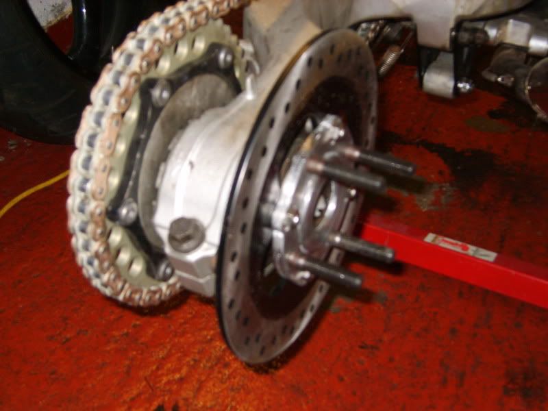

Post by Exile on Sat 20 Mar 2010, 23:55
VFR hub fitted with extra long high tensile studs
Exile
Location : HEE-TROW
Re: Bitza-Blade

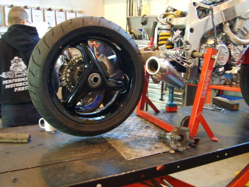

Post by Exile on Sat 20 Mar 2010, 23:57
30mm spacer plates to give wheel alignment
Exile
Location : HEE-TROW
Re: Bitza-Blade
Post by Exile on Sun 21 Mar 2010, 00:00
And voila
Simples !!

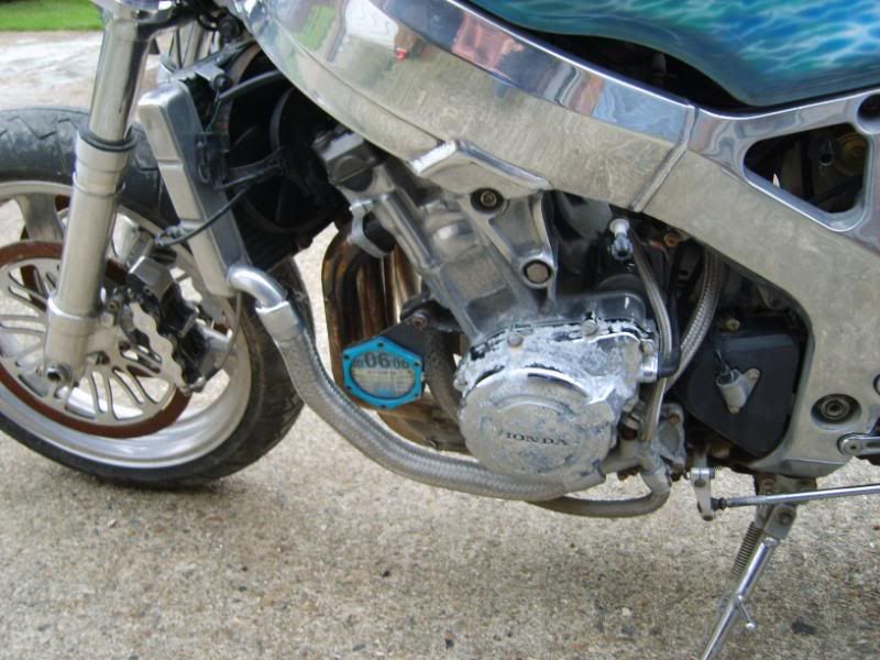

Post by Exile on Sun 21 Mar 2010, 01:42

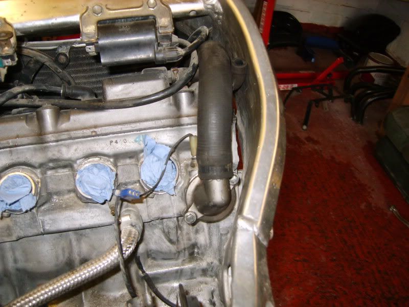

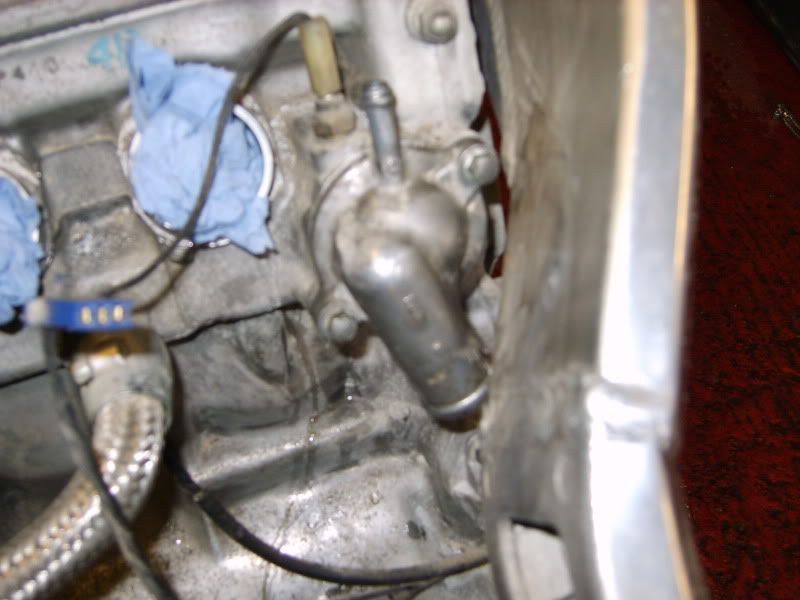

working on the cooling system
The top hose run to the rad as always done my head in on the Blade, and its all down to the stat housing so i gotta thinking....
Heres the std Blade item fitted

Re: Bitza-Blade
Post by Exile on Sun 21 Mar 2010, 01:44
And heres a 900 Hornet stat housing compared to the std item

Re: Bitza-Blade
Post by Exile on Sun 21 Mar 2010, 01:46
And the Hornet stat housing in place giving an up and over top hose bounce

Re: Bitza-Blade
Post by fastbikefinder on Sun 21 Mar 2010, 01:51
Good idea!
Will you upgrade the fan?
