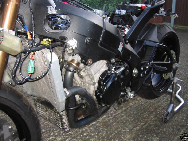

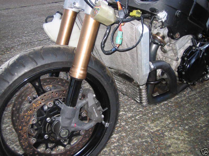

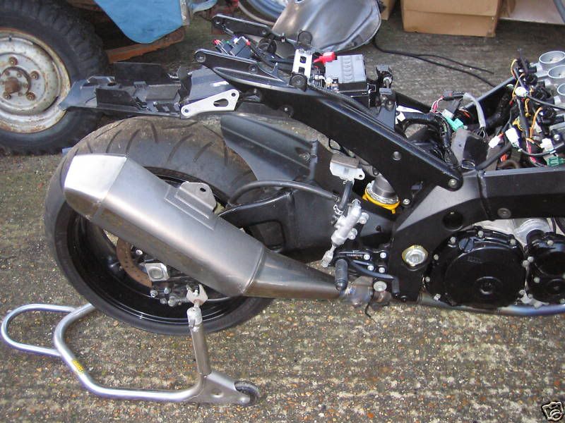

Well it's not a blade guys but something to keep me busy!
It's a 2005 GSXR1000 as you can see it's been in the wars but I think it's salvagable
I may fight it or go back to standard-ish spec not sure yet?
I may have to change the frame, we'll see, but it was to cheap not to go for it!

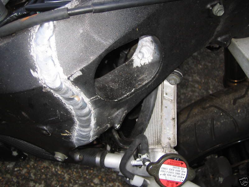

It certainly does look like its been in the wars but they are bullet proof to an extent..
Do you know anything about that frame repair? that's the only thing that would concern me paranoid

This has happened a few times, so frame faults arnt unheard of.

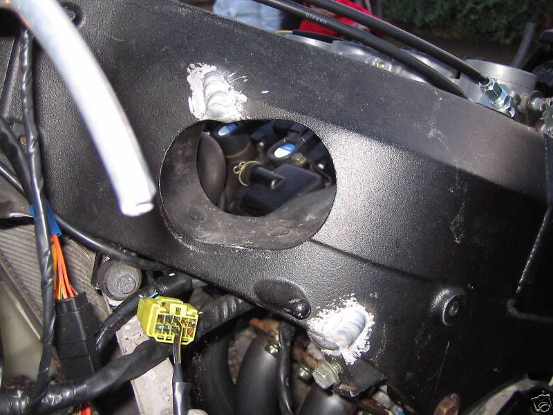

I'll check it out when I get it but I think I'll probably sit on the safe side of the fence & replace it with a good un & see if I can sell the one on there but that will all depend on paperwork etc...
The seller said it's been jigged & welded but to be honest I would be a little concerned about the frame with all that power running through it.

It happened going into druids at oulton park, has also spilt on a few club racers.
There is a recall to brace the area.

The factory welds are not up to the job, to do with the robot production line and the heat setting.
The frame brace is a bolt on around the headstock,
They wont recall if it is recorded though.........infact they wouldn't recall if it's had a frame repair either.
Best bet to buy a non recorded frame, then get the free brace treatment on that. Also, on inspection, if they find any cracks then they give you a new frame with a 5 year guarantee.
