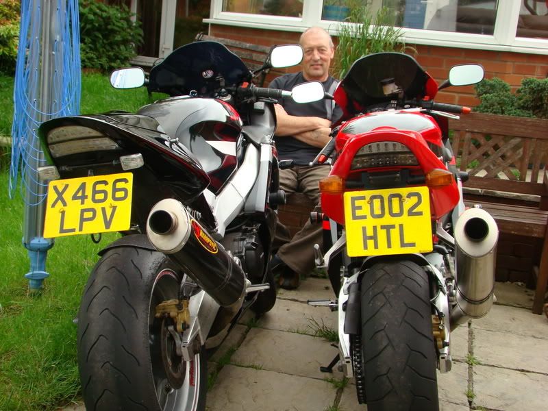

I fitted a 954 tail unit to my 929,a bit of cutting about but its on.[img][/img]

Thats not me by the way............The Red 954 is my m8,s mine is the Black 929

To be honest,Why would you want to??,the 954 is by far a better looking tail unit,if a RR4 or later was about at the time I would have used one of those but this one was CHEAP!

He,ll have to make the subframe narrower and shorten it by about 3 inches aswell as bend it up a bit,then weld the OE catch back into place,then make a undertray to fit.
