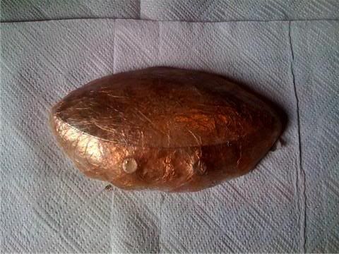

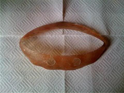

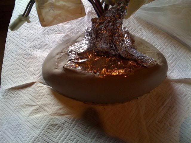

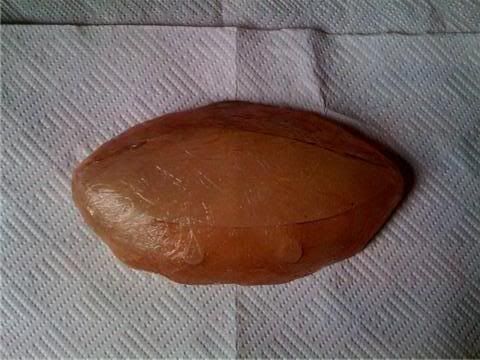

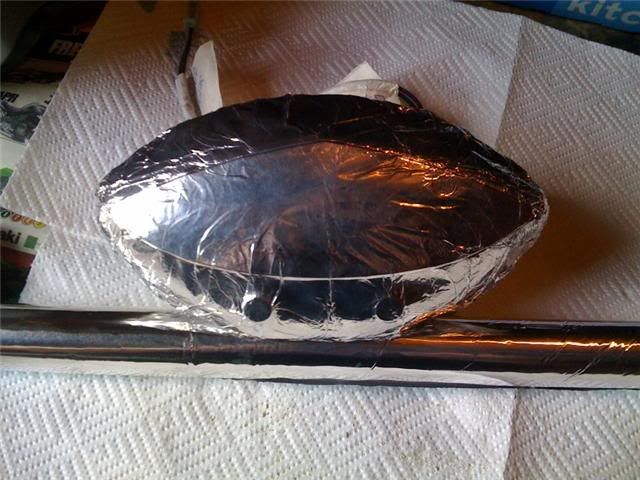

Ok I've been busy getting stuff done! sunny

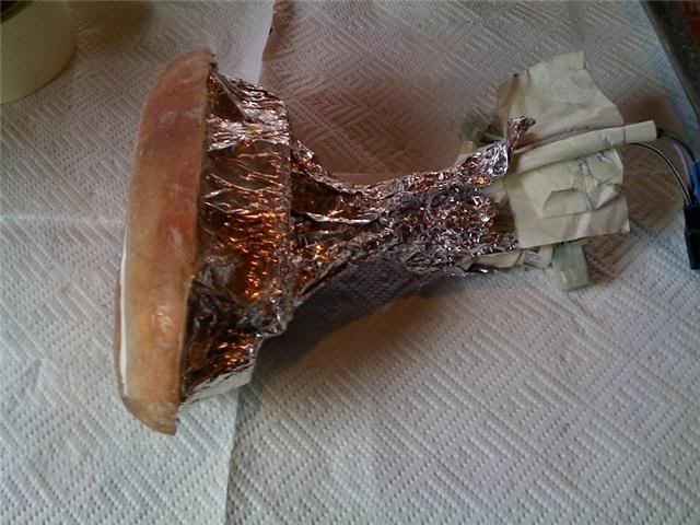

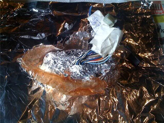

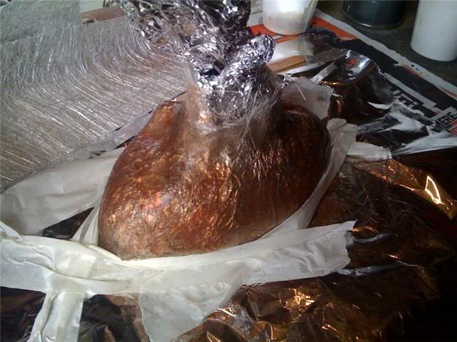

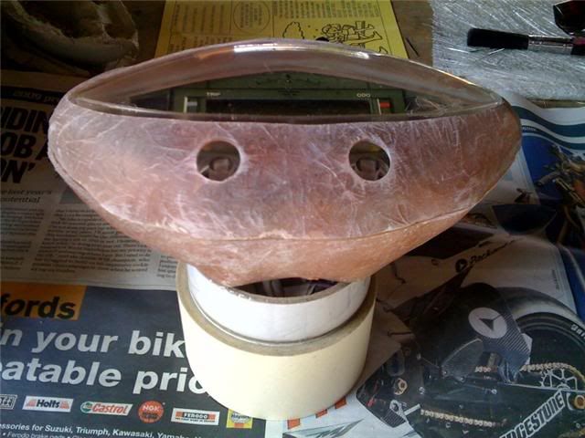

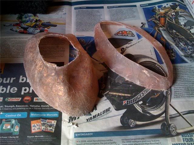

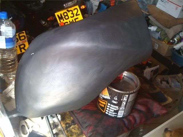

I'm half way through building a new pod for the new clocks, sanded down & reprayed the tank, got some new stickers to go on the tank, got another replacement shock, a matching colour scheme helmet & some fcr carbs for the zx7r! woot
Here's what I've done so far with the clocks.

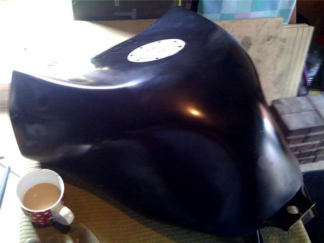

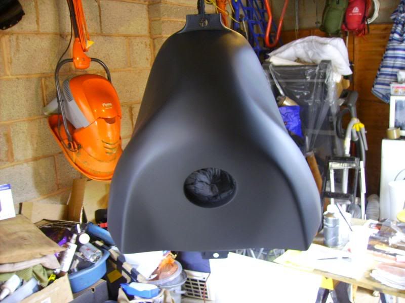

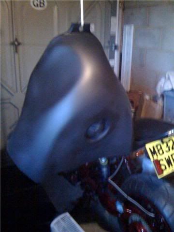

I tried polishing out all the marks on the tank where the fuel spilled all over it but it just looked rubish, so I rubbed it down & repainted it.
When I first resprayed it I think there was to much moisture in the air & the finish was aweful!
So I chucked on the heater & warmed up the tank & garage & got a much better result!

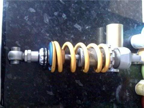

Here's the replacement shock which fits a treat, I'm also waiting for a shock sock to arrive, it covers up the spring to protect it but I just want it to cover up that ugly yellow spring until I get it powder coated!

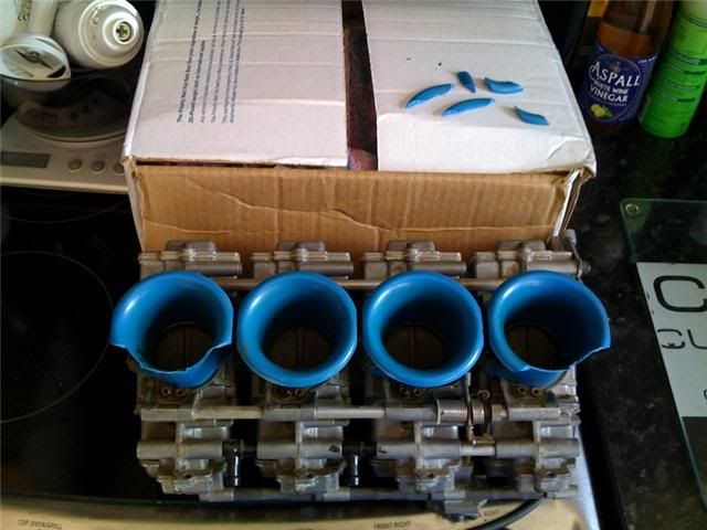

I also got myself some FCR carbs to go on the ZX7R, sadly when they arrived the 2 outer stacks got damaged whilst being shipped over from the states!

Wow, I thort it was Easter when I started reading! Lol. All that tin foil! Laughing
You been bizy. cool lid. shame about the stacks.

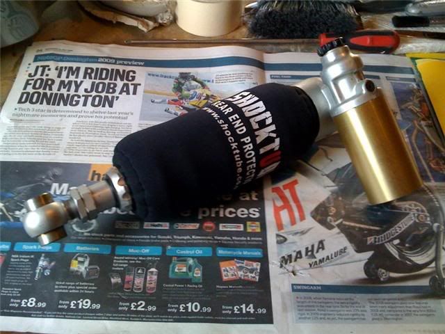

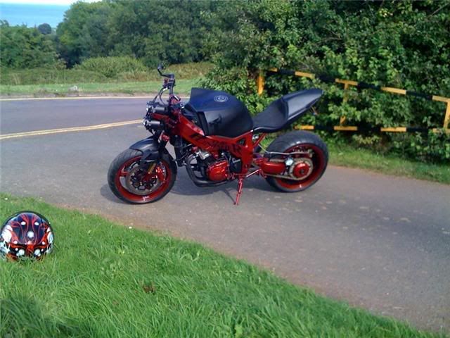

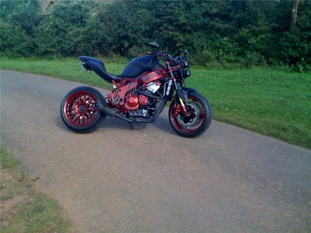

The shock tube arrived today so I fitted the shock & adjusted the shock to its highest setting but its no where near as long as the ohlins when I had it on its max height settings. SO I had a go at turning the shock triangle linkages but I think I must have had them on there highest setting already as everything I tried was just lower than I started off with scratch
The aprilia rsv mille shock isn't as stiff as the standard blade one, so I'm not sure if it needs re gasing or what as I've had to set it on the hardest setting as it feels really soft scratch
I went on to drop the yoke lower down the forks to even out the ride height & it's made the frontend look that bit more aggresive & the headlights are now much closer to the handlebars which looks better in my opinion. I think I might go get a smaller number plate as with the seat being lower now it looks to big Rolling Eyes
Hers's the shock with it's cosy tube fitted Laughing
I'll post up some pics of the bike together tomorrow thumbup

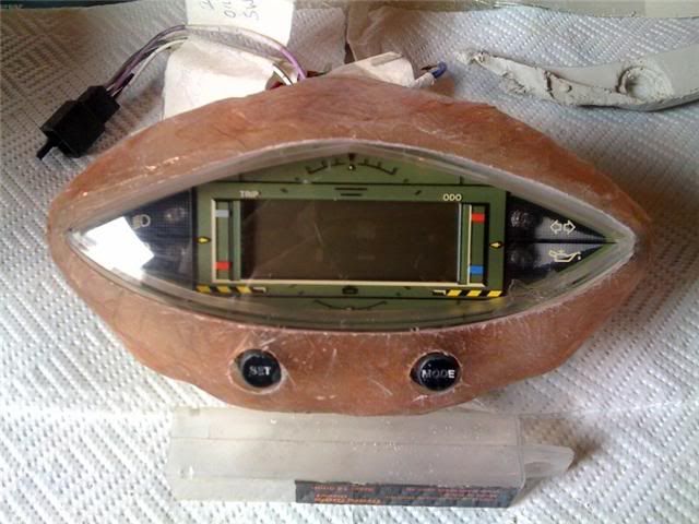

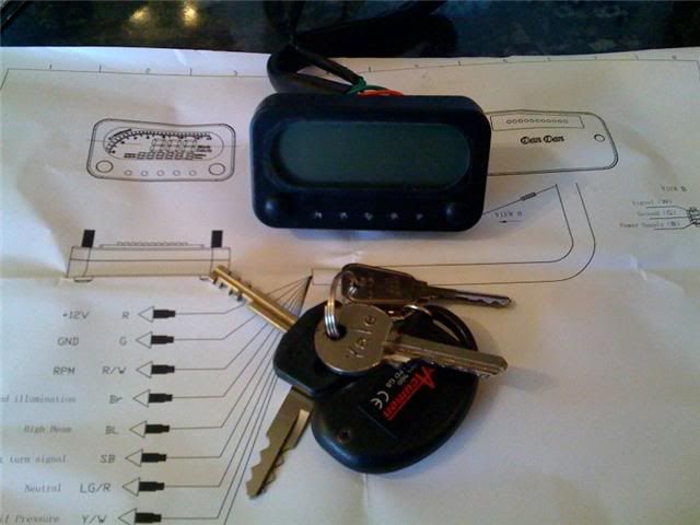

OK the speedo I was making may be scrapped as I order some time ago a mini speedo from china but thought it may not turn up in time for me to fit it ready for the show this weekend, but it just arrived! dance
It's small alright & there are english instruction included but no instructions for how & where to fit the magnet & magnet pickup scratch
I just emailed the seller & I'm waiting for a response. Also one of the wires were lose & broke away from its soldering point so I'll have to re solder that, no real biggy though.
Here it is.
Re: My 94 Streetfighter Project
Post by fastbikefinder on Thu 27 Aug 2009, 08:36
Does it not mention whether it's fork or gearbox mount?
Does it mention calibrating it for different size wheels?
Looks pretty snazzy!

fastbikefinder wrote:Does it not mention whether it's fork or gearbox mount?
Thanks FB!
The seller contacted me & said its fork or swingarm mounted but I sussed that out yesterday & made a braket up, but I also notice that the sender has three wires on it, ground, live & sensor so I'm going to see if it'll wire direct to the speed sensor pickup on the bike as I think it may well work like that & I'd rather not have to use the magnet setup & keep things cleaner looking.
Yep it does mention calibrating it for different wheel sizes & from what I've found on the net it should be 1357mm for a 17 inch wheel but I'll have to set it up & check it out.

What a bleedin frustrating day I've had!
Well as it is at the moment the speedo is a total waste of space!!!
I wired it all up & also soldered the wire that was hanging out of the box, I turned on the ignition & it lit up & then it all went dull again! rant The only thing that works is all the idiot lights, other than that it's not happening! Evil or Very Mad
I even prised it apart to check everything was ok but all looks ok.
I'm rite peed off :302:
Looks like I'm gonna go buy a speedo for a push bike as I gotta have the bike ready for the show tomorrow, worst case I'll ride it up to the show first thing saturday morning.

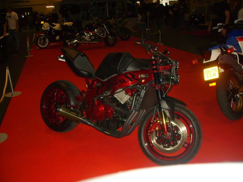

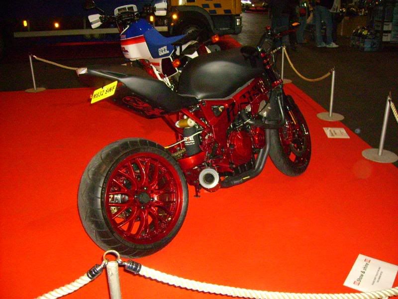

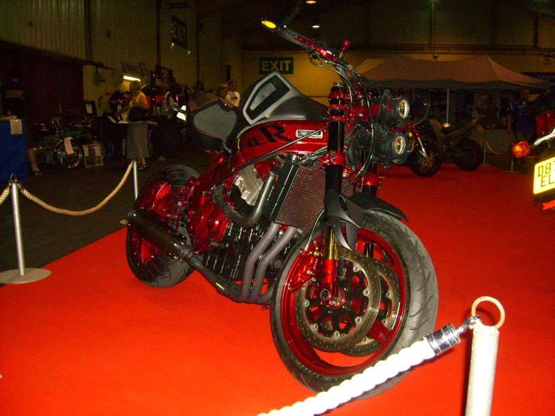

Hi all, I had a great weekend! hyper

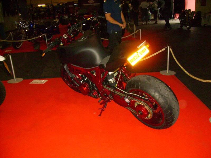

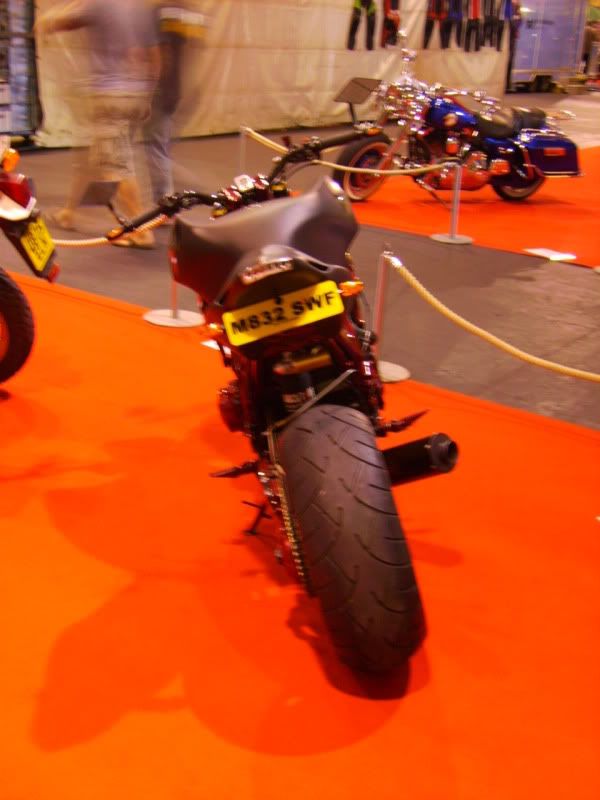

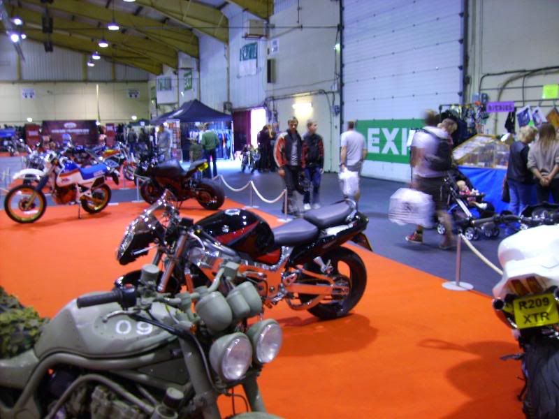

I rode the bike up to exeter, westpoint saturday morning to put my bike on the streetfighters stand as they invited me up as I'm local. What I didn't know was that it was also a bike show competion & when I got there I was asked to fill out a entry form, so I thought what the hell I'll enter for a laugh! Laughing
Here it is on the stand
It attracted a lot of attention & I found it funny watching people walk past it & seeing them look at it out of the corner of there eye & then do a double take & stop with either a look of total wonderment or total discuss! rofl There was lots of scratrching of heads scratch & a bit of swearing & lots of pics being taken, I loved seeing people enjoying it as much as I do!
I thought it a bit strange to be taking pics of people stood lookin at my bike so I only took the one! screwy rofl

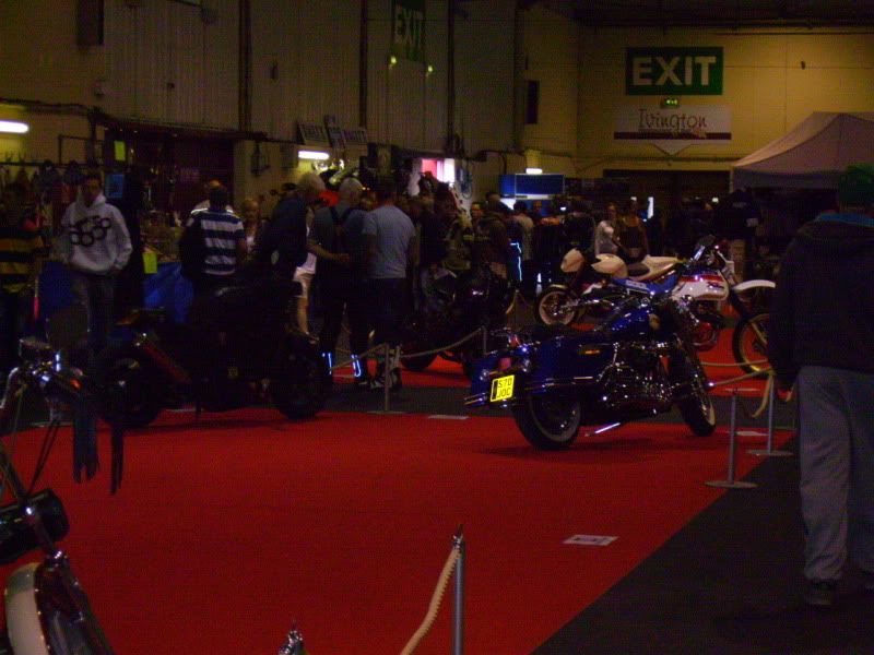

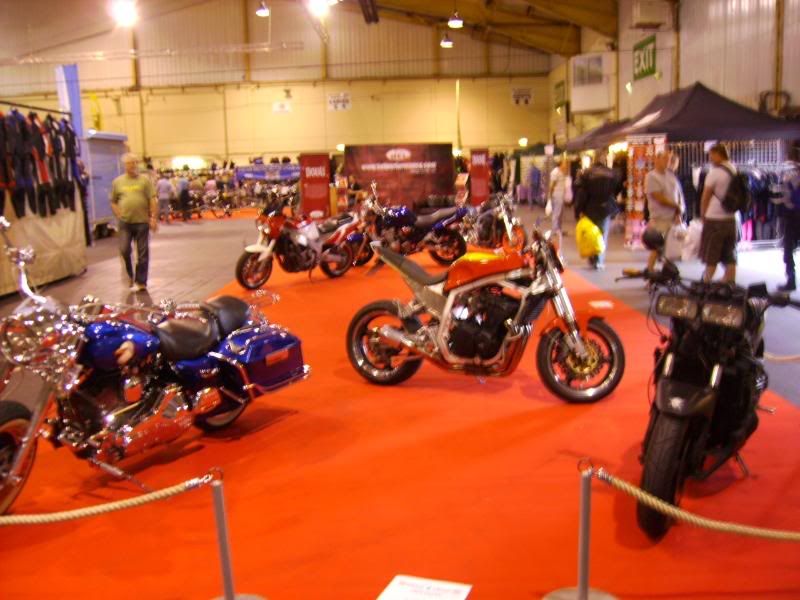

Here's some of the bikes on the streetfighters stand, they had different bikes for different categories, such as show & shine, modified, engineering, not sure of the others + other bikes were in the comp on different stands but I didn't get any pics of those.
Here's mine again!
Anyhow, very very much to my surprise I won best engineering bike in show!! happyahh
Here I am with Dave Manning being awarded my trophy, I also got a bag full of autoglym cleaning products which was very nice!
This trike won best bike in show, it was awesome & really needs to be seen in the flesh.

Post by a_morti on Mon 31 Aug 2009, 23:59
Good effort and glad it's going well for you. The standard of finish is very impressive, if not to everyman's taste.
Two points: You missed a trick by not running the rear brake line through the swingarm. The exhaust is untidy, just trimming the link pipe a bit further would tidy it up. Put the can hanger off the frame mount instead of the link pipe.
Will I be flamed for asking what the best engineering bit is in a standard main frame and engine with a tried and tested swingarm switch and different front end?
